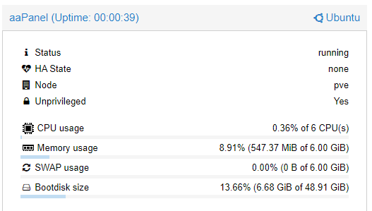

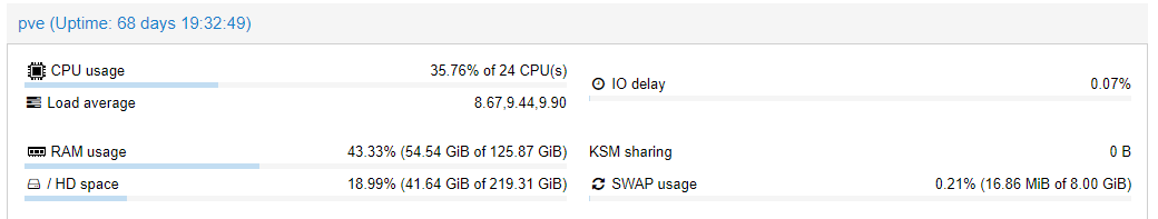

Brain aaPanel_Kern can you tell me please about that's problem? i mean, is this problem on the computer server? or the proxmox? or the configuration my proxmox? or configuration my aaPanel? i need to fix it, 'couse i wanna use aaPanel on this last month
aaPanel_Kern It can be used. It is recommended that you check whether the load of the server running proxmox is normal. Brain
aaPanel_Kern This seems to be a configuration problem of proxmox. I suggest you check whether any configuration has been added. What version of proxmox are you using? Brain
Brain aaPanel_Kern Proxmox Virtual Environment 8.1.4 if the problem is the proxmox configuration, but in other VMs it is normal... so I think the proxmox configuration is not a problem

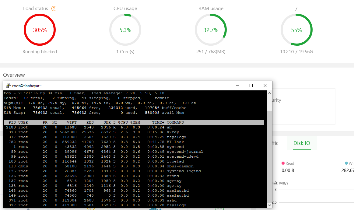

aaPanel_Kern Hello, I suggest you check it yourself. This is a check within the operating system that has a high load, and aapanel only reads. It is recommended that you stop all programs and check again Brain

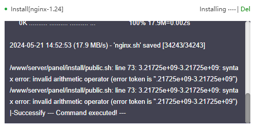

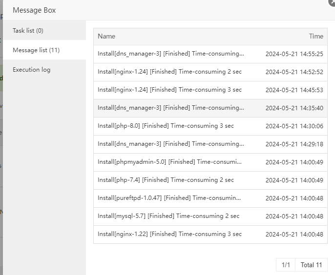

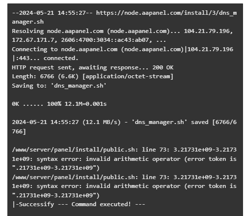

Brain aaPanel_Kern okay now Load Status is normal, but why can't I install Plug-in like Nginx, DNS Manager, PHP

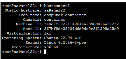

aaPanel_Kern Hello, it is recommended that you use VM instead of LXC container. LXC container has CPU identification problem. Brain
aaPanel_Kern Hello, this is a system or lxc container problem. It is recommended that you use VM. This is not aapanel's problem. You can use lscpu to check if the number of CPU cores you set is inconsistent. Brain

Tianheyu Is this normal?How it can over 100%? Checked it, All loads are below 100, the only possibility is that the physical machine load is too high. Can this conjecture be confirmed?
aaPanel_Kern Hello, is this a server built using LXC? What version of operating system are you using? Tianheyu
