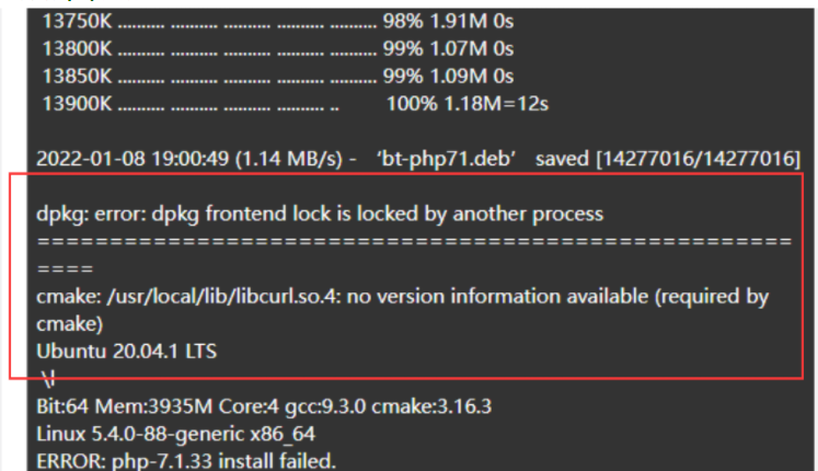

dpkg is locked, causing installation of php to fail
Solution:
mv /var/lib/dpkg/lock /tmp/lock_back
mv /var/lib/dpkg/lock-frontend /tmp/lock-frontend_back
mv /var/cache/apt/archives/lock /tmp/lock_back
dpkg --configure -a

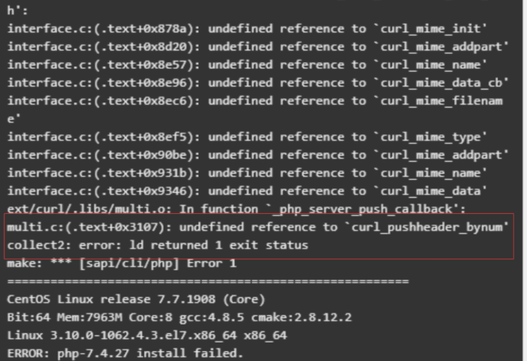

When installing: undefined reference to `curl_pushheader_bynum'
Solution:
It is found that the problem is caused by the curl-devel conflict of the server itself. The Solution:
Redhat|CentOS:
yum remove curl-devel
