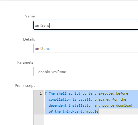

Hello, you can choose to compile and install to enable these two modules when installing apache
--enable-proxy-html
--enable-xml2enc
After the installation is complete, add the enable module at line 153 of the configuration file
then restart apache
LoadModule xml2enc_module modules/mod_xml2enc.so
LoadModule proxy_html_module modules/mod_proxy_html.so
