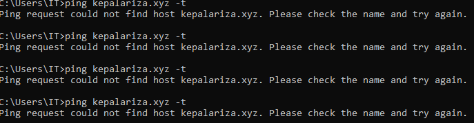

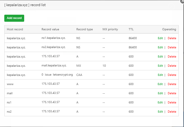

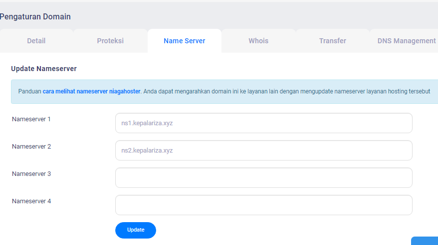

aaP_riza_robby i've configure my aapanel using DNS apps like this and my name server on dashboard domain like this then i try with ping in cmd, this yet connect each other? its mean betwen server and domain are not linked yet. How to fix this?
aaPanel_Kern aaP_riza_robby Hello, do the ns1 and ns2 of the domain name point to the ip of the server? https://doc.aapanel.com/web/#/3?page_id=180
aaPanel_Kern aaP_riza_robby Which domain name provider are you? It is recommended that you use the domain name provider's management website directly.
aaP_riza_robby aaPanel_Kern anw is server need instal BIND9? if yes, i doesnt installed yet it if bind9 possible, fix this problem?
aaPanel_Kern aaP_riza_robby No need to install bind9 The panel uses pdns, it is recommended that you directly use the management website of the domain name provider.
aaPanel_Kern aaP_riza_robby Only one of pdns and bind9 can be used. panel uses pdns. You can install bind9 by yourself, but the panel cannot manage it.
aaPanel_Kern aaP_riza_robby Try to click "Restart" on the Service interface in DNS Manager, and then go to the domain name provider to see if there is a record. If it doesn't, it's not working properly. It is recommended to use the domain name provider's administration website directly.
