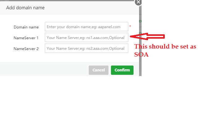

You need to understand that in AAPANEL default settings such as:
$TTL 1D my.domain. IN SOA f1g1ns1.dnspod.net. admin.my.domain. (
0 ; serial
1D ; refresh
1H ; retry
1W ; expire
3H ) ; minimum
On the first line you are basically saying "Here, f1g1ns1.dnspod.net. is the master nameserver of the zone" which obviously is not true and should never be true. Someone in control of f1g1ns1.dnspod.net can do some nasty stuff with the zone's DNS.
And even if it can do harm, many tools that help diagnose DNS problems will fail due to the master zone being outside of AAPANEL operator's control.
From the SOA RFC
The fully-qualified domain name of the primary or master name server for the zone file. Within the structure of DNS, there can only be one server that holds the master, editable zone file. All secondary name servers create their zone files by transferring the contents from the primary name server. Changes to the domain's resource records are made to the primary name server's zone file and are then propagated to the secondary name servers when they check for updates.
So as a solution, when someone uses AAPANEL to host a DNS zone, please look at the attached image and set as the default SOA the value of NameServer 1.
