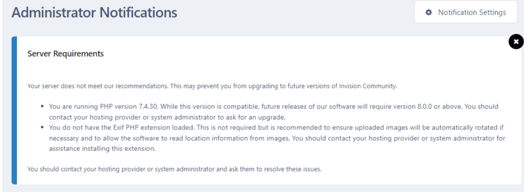

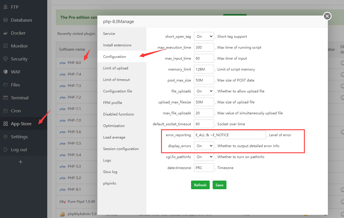

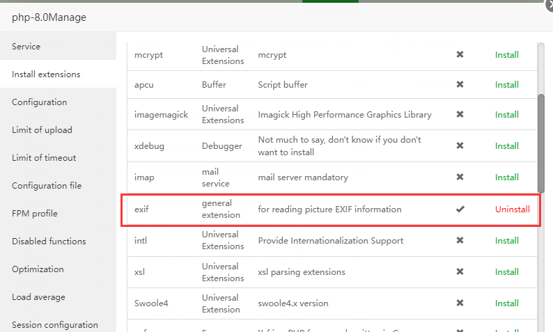

aaPanel_Kern aaP_mani5grockers Install the php required by your site, such as 8.0 can be installed in the app store, pay attention to whether there is an error in the installation process. After the installation is successful, find your site on the Website interface of the panel and replace php with php-80. The log can be turned off or changed in the Configuration interface. The exif extension can be found and installed in the Install extensions interface.Pay attention to the installation process for errors.
