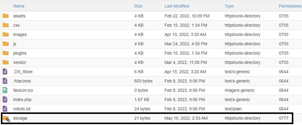

aaP_krissiankg hi friends I have to create a folder with a link like on this picture in my aapanel how can i proceed ? thanks for your help

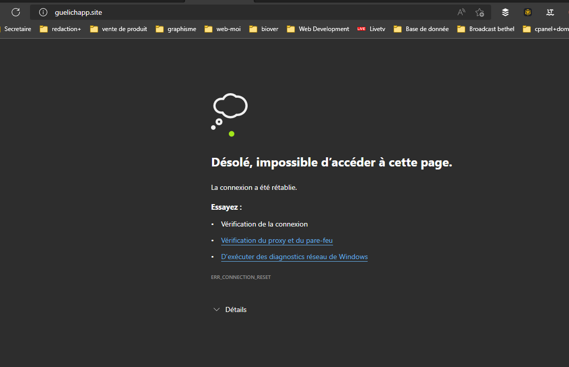

aaP_krissiankg aaPanel_Kern May I take this opportunity to submit an urgent problem to you? my site is no longer displayed. I don't know what I did but since yesterday, here is the result I have. Can you show me the problem first? please

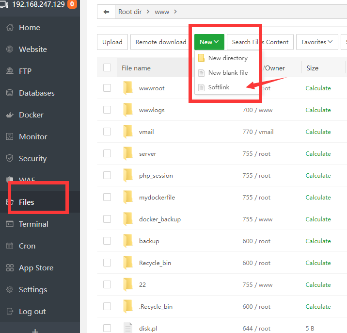

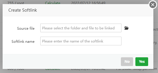

aaPanel_Kern aaP_krissiankg Try: Soft link of the panel: Enter the directory that needs a soft link, then New --> Softlink to complete the establishment according to the prompts

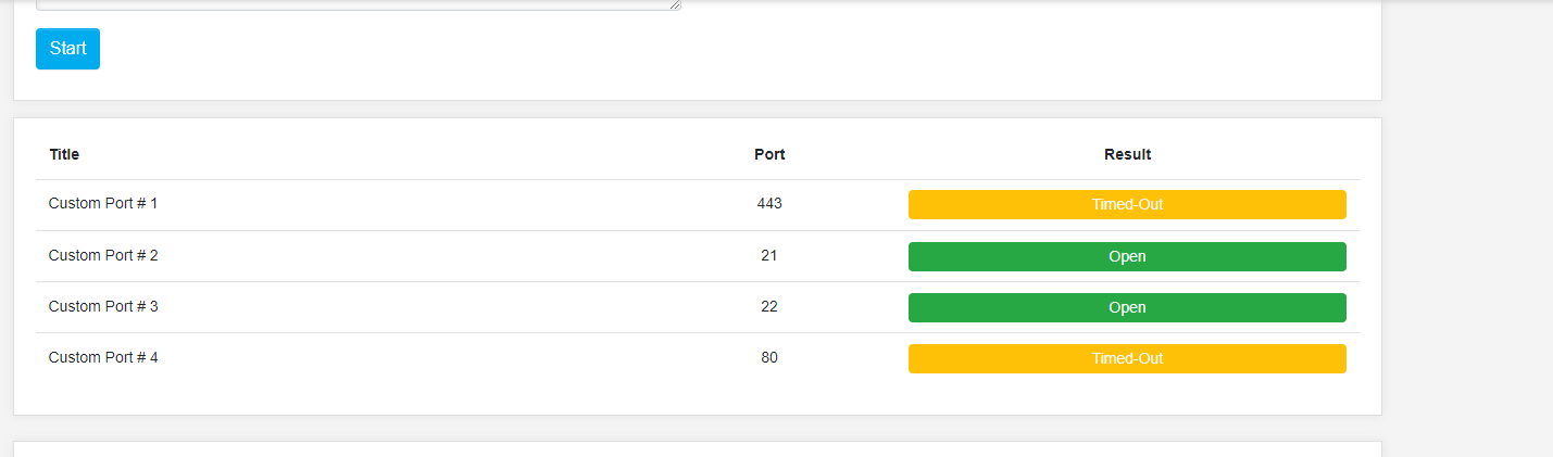

aaPanel_Kern aaP_krissiankg Use this url to check if port 80, 443 is open? https://dnschecker.org/port-scanner.php Is the web service running? can be viewed in the app store

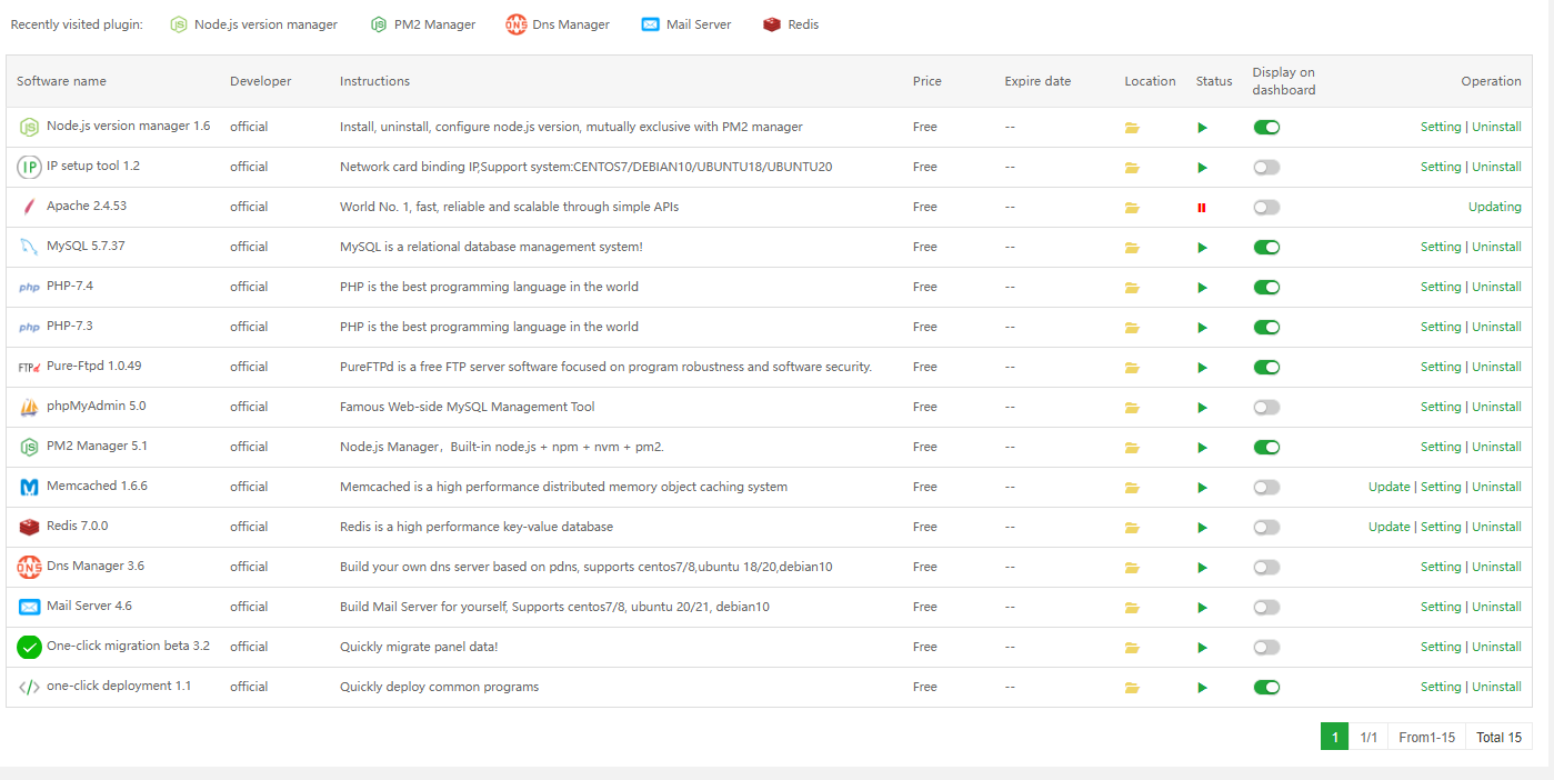

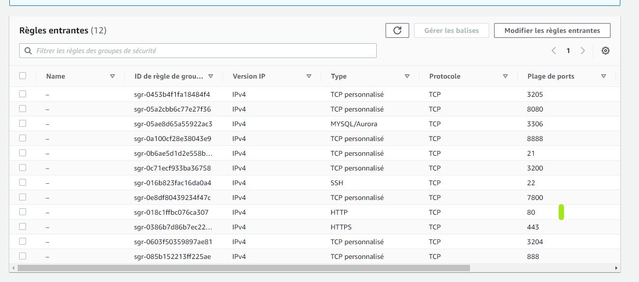

aaP_krissiankg aaPanel_Kern I have checked the ports here is the result but I have the ports open on my aws console Here are the installed services Do you have a problem? I see Apache paused: could this be the cause?
aaP_krissiankg aaP_krissiankg My problem is solved. I restarted the panel and the sites are displayed normally now
