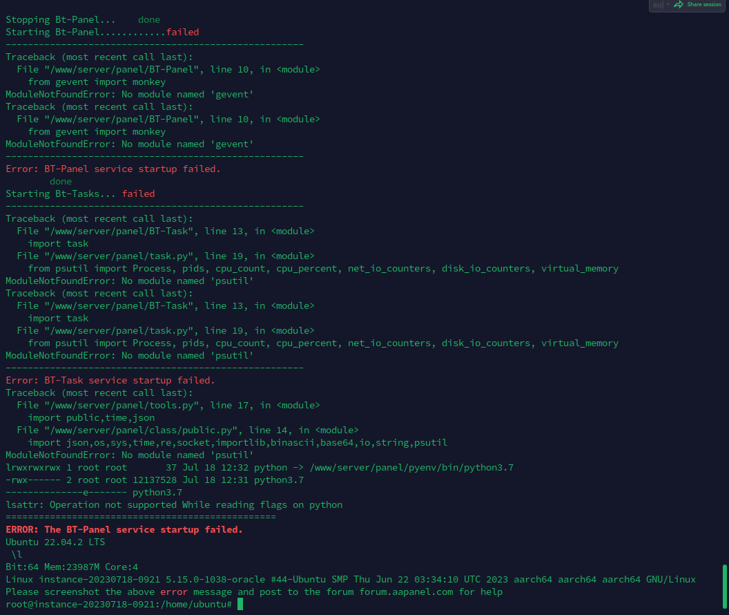

aaPanel_Kern aaP_esistemasinteligentes Hello, is it normal to try to reinstall once? Also check whether the installation process is normal? Where is your server located? Is it possible to use pypi source?
aaP_esistemasinteligentes aaPanel_Kern I already tried to reinstall, and yes, it is possible to use pip.
aaP_esistemasinteligentes I ran the installation with sudo su, it worked, but it doesn't access the given address. keeps loading.xxx
aaP_esistemasinteligentes I managed to solve it, I'm using oracle cloud, arm64, I used sudo su and installed the panel without any error, after I released the ports that AAPANEL needs.
aaPanel_Kern Hello, please check whether the security group of oracle cloud has opened the port used by the panel? The default is 7800 aaP_esistemasinteligentes
