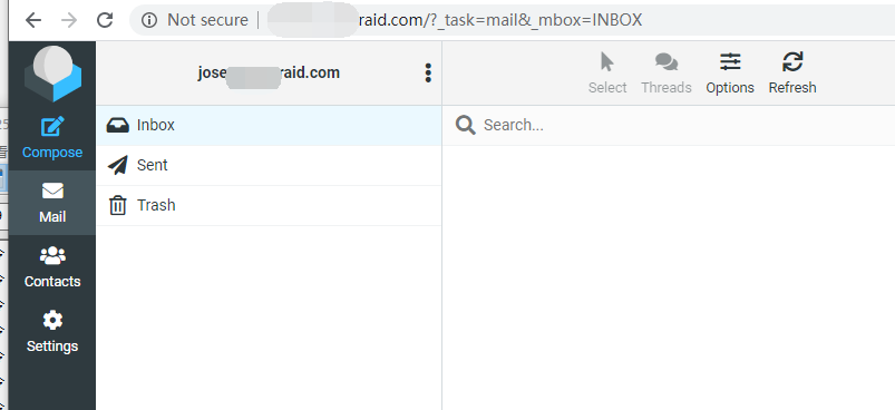

aaPanel_Jose webwide ok, let me login your panel to check Update: I just created a user jose and successfully logged into your webmail, I did nothing. . Please try to modify your user password and try again
webwide aaPanel_Jose Okay, Jose. Thank you so much for your prompt response. Thanks a ton for saving my time. Actually, I was doing it a wrong way.Sorry.I have logged in successfully now and able to send and receive emails. https://ibb.co/7207rB9 How to configure to the thunderbird mail platform so that I don't have to log in to RoundCube again and again? One more thing do I have to create multiple Roundcube for multiple websites?
