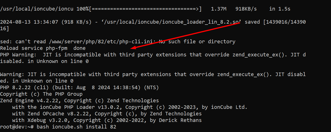

Adrian aaPanel_Kern Ok, and I tried your method from this topic https://www.aapanel.com/forum/d/3233-install-ioncube-loader/13 but I have this error.
aaPanel_Kern try: wget https://node.aapanel.com/install/3/ioncube.sh bash ioncube.sh install 82 Adrian
aaPanel_Kern aaPanel_Kern wget https://node.aapanel.com/install/3/ioncube.sh bash ioncube.sh install 82 Adrian

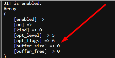

AkramiPro if we install ioncube using this script php jit is not working anymore am i correct ? aaPanel_Kern
AkramiPro sorry i found the problem. i enabled xdebug that had caused jit not working disable xdebug and jit start working again
