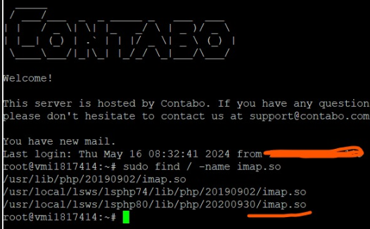

I give the command in the terminal and it appears

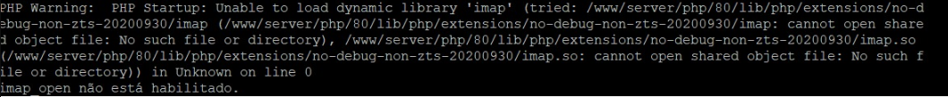

When I confirm it is not found and imap_open is not enabled

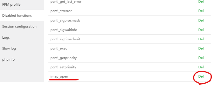

I found him here

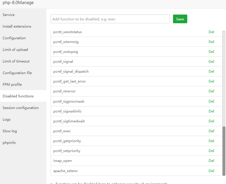

I went to some responder forums, where I would have to enable imap_open in php.8.0, according to some images, but I'm not sure if it's for DEL (delete in this case?)

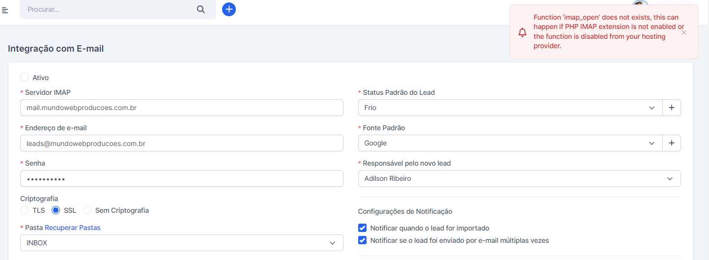

The error when I configure imap in Perfex
