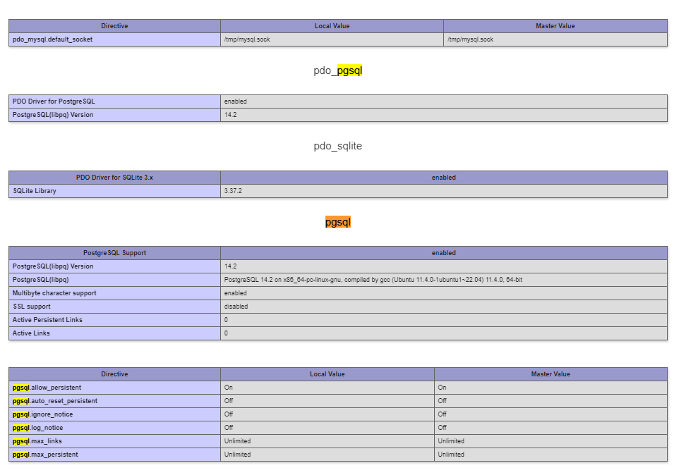

ianasystems Check this image it's PHP 7.4 and its shwoing pgsql installed successfully. now check this image it's php 8.1 and its showing pgsql not installed

ianasystems aaPanel_Kern Finally I've done. PgSQL For PHP 8.1 using this method. https://www.aapanel.com/forum/d/13370-why-php-81-dont-have-pgsql-extendsion version=81 echo $version cd /www/server/php/$version/src/ext/pgsql /www/server/php/$version/bin/phpize ./configure --with-php-config=/www/server/php/$version/bin/php-config --with-pgsql=/www/server/pgsql make && make install extFile='/www/server/php/$version/lib/php/extensions/no-debug-non-zts-20210902/pgsql.so' echo -e "extension = " ${extFile} >> /www/server/php/$version/etc/php.ini echo -e "extension = " ${extFile} >> /www/server/php/$version/etc/php-cli.ini /etc/init.d/php-fpm-$version reload Thanks Dear @aaPanel_Kern
