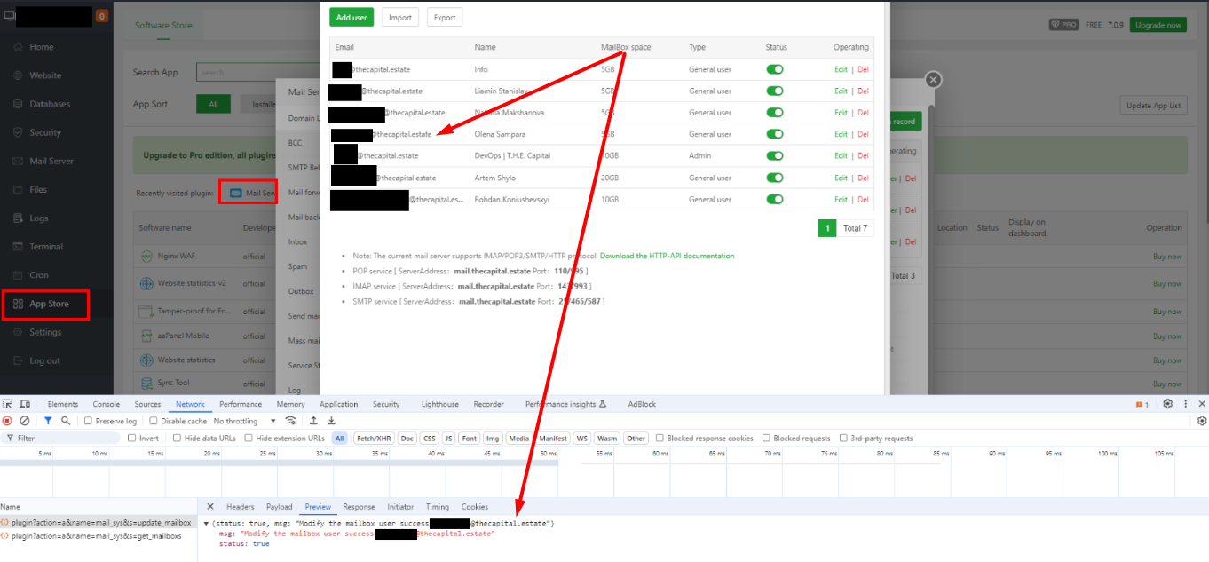

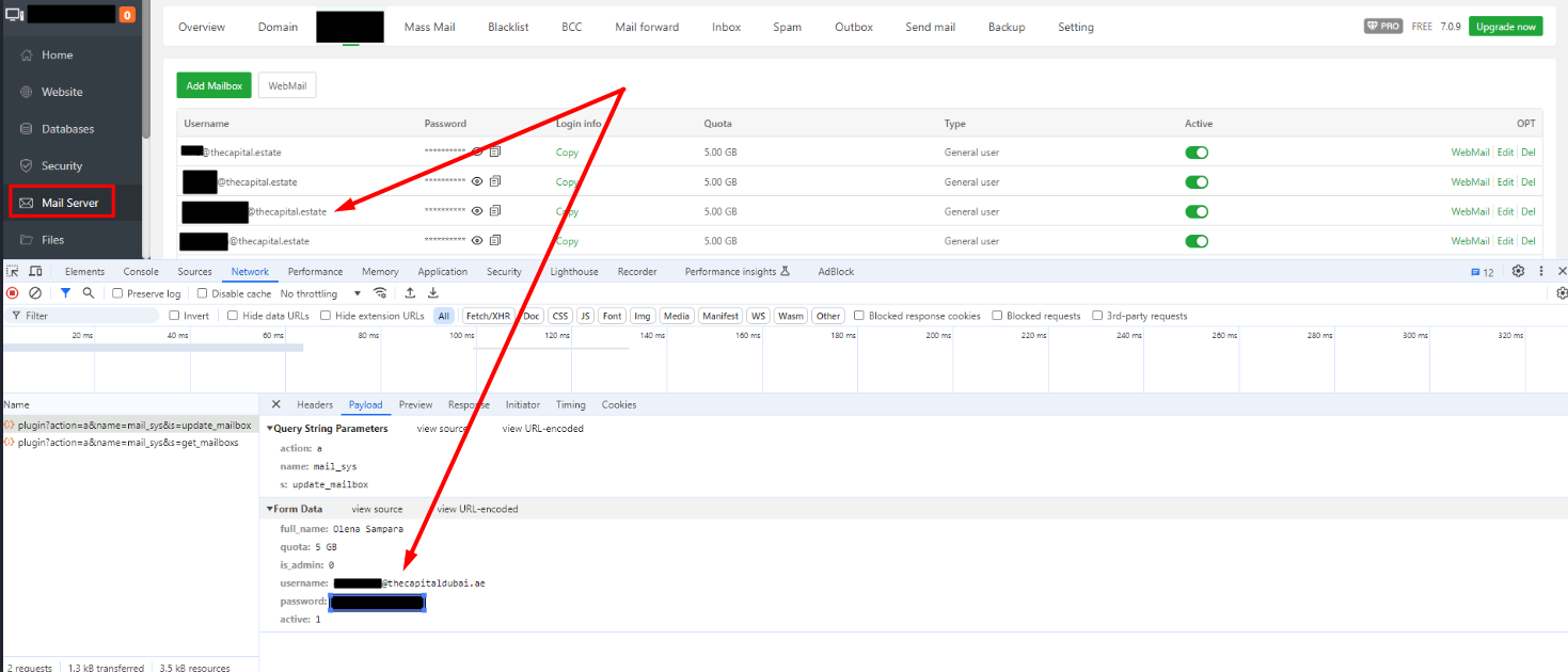

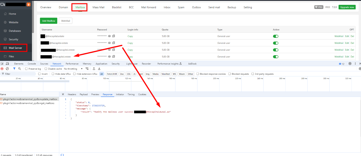

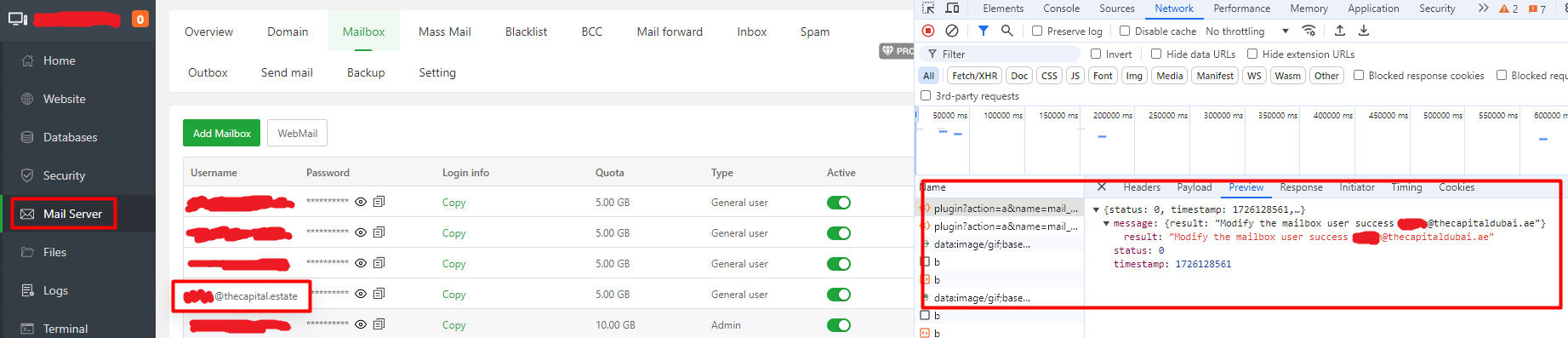

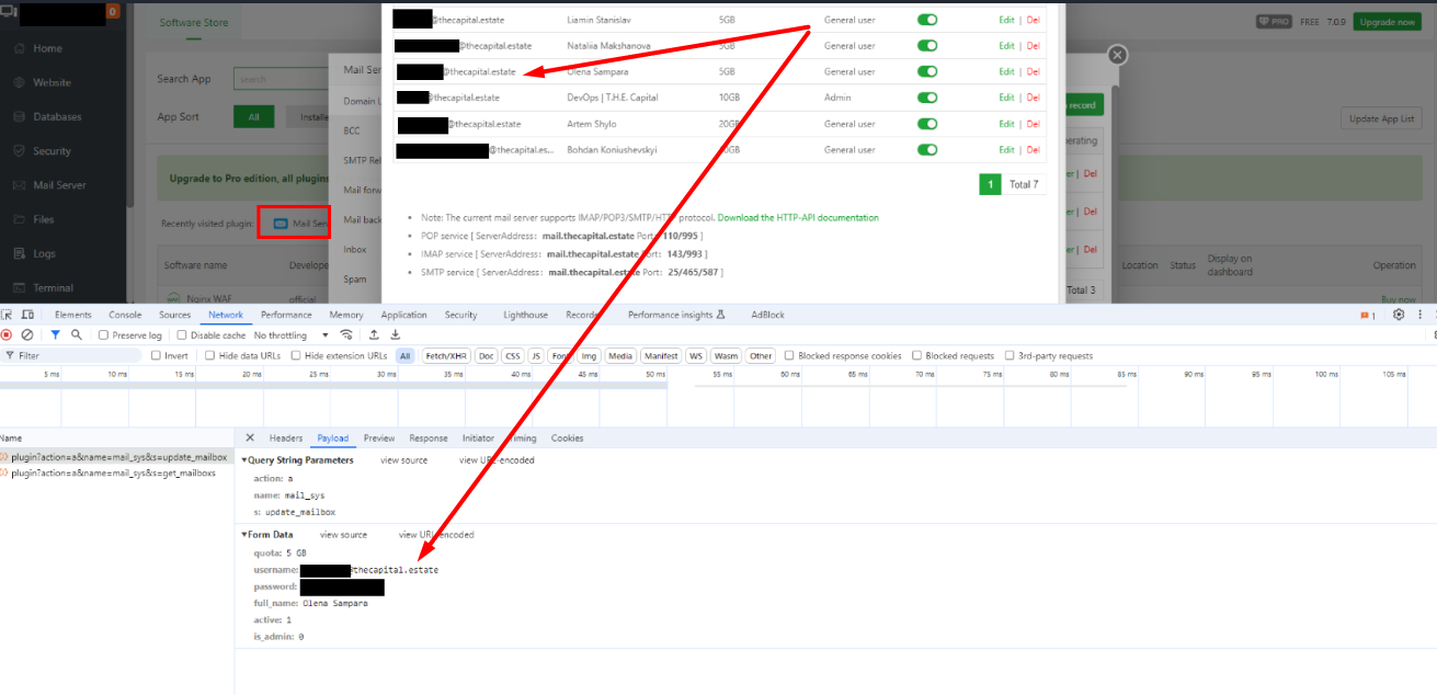

I can't provide access. You can try the same configuration as ours and you will understand what the problem is. The configuration is as follows: there are two email domains (domain 1 and domain 2), when you try to change the password for an email belonging to domain 2, the request is sent to domain 1. Below are screenshots of the action and the inspector’s output.
P.S. There are actually 3 domains. Through the new module, requests are sent to the last added domain.
