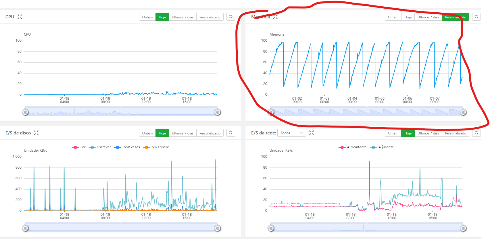

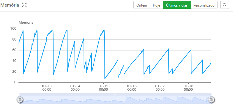

aapanel BT-task consumes memory until it reaches 100%
follow the logs that I can send

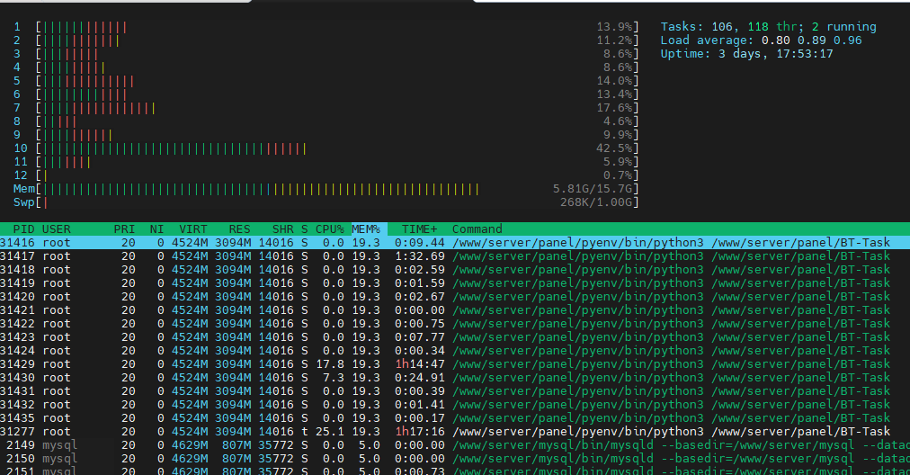

the process constantly increases memory consumption, creating a kind of saw all the time
When it doesn't reach 100% and I have to restart from time to time, I go to ssh, type bbt and choose option 1 and then the consumption drops immediately, I've been doing this for 30 days about 4 times a day so my system doesn't stop
ps -eo rss,pmem,pcpu,vsize,args | sort -k 1 -r -n | less
2952328 17.9 18.9 4412892 /www/server/panel/pyenv/bin/python3 /www/server/panel/BT-Task

root@mongoliaapi:~# ps aux | grep "BT-Task"
root 8604 0.0 0.0 14432 1012 pts/1 S+ 18:29 0:00 grep --color=auto BT-Task
root 31277 18.9 18.3 4475356 3010912 ? Sl 12:03 73:09 /www/server/panel/pyenv/bin/python3 /www/server/panel/BT-Task

BT-Task 31277 root mem REG 252,1 82248 1037101 /www/server/panel/pyenv/lib/python3.12/lib-dynload/termios.cpython-312-x86_64-linux-gnu.so
BT-Task 31277 root mem REG 252,1 27112 1433 /lib/x86_64-linux-gnu/libuuid.so.1.3.0
BT-Task 31277 root mem REG 252,1 119217 1034588 /www/server/panel/pyenv/lib/python3.12/site-packages/psycopg2_binary.libs/libsasl2-883649fd.so.3.0.0
BT-Task 31277 root mem REG 252,1 60977 1034595 /www/server/panel/pyenv/lib/python3.12/site-packages/psycopg2_binary.libs/liblber-5a1d5ae1.so.2.0.200
BT-Task 31277 root mem REG 252,1 28440 1037070 /www/server/panel/pyenv/lib/python3.12/lib-dynload/uuid.cpython-312-x86_64-linux-gnu.so
BT-Task 31277 root mem REG 252,1 667664 1037115 /www/server/panel/pyenv/lib/python3.12/lib-dynload/pickle.cpython-312-x86_64-linux-gnu.so
BT-Task 31277 root mem REG 252,1 1082648 1742 /usr/lib/x86_64-linux-gnu/libsqlite3.so.0.8.6
BT-Task 31277 root mem REG 252,1 638384 1037107 /www/server/panel/pyenv/lib/python3.12/lib-dynload/sqlite3.cpython-312-x86_64-linux-gnu.so
BT-Task 31277 root mem REG 252,1 36840 1037100 /www/server/panel/pyenv/lib/python3.12/lib-dynload/opcode.cpython-312-x86_64-linux-gnu.so
BT-Task 31277 root mem REG 252,1 252456 1037076 /www/server/panel/pyenv/lib/python3.12/lib-dynload/multibytecodec.cpython-312-x86_64-linux-gnu.so
BT-Task 31277 root mem REG 252,1 1274832 1037112 /www/server/panel/pyenv/lib/python3.12/lib-dynload/unicodedata.cpython-312-x86_64-linux-gnu.so
BT-Task 31277 root mem REG 252,1 370777 1034590 /www/server/panel/pyenv/lib/python3.12/site-packages/psycopg2_binary.libs/libpq-e8a033dd.so.5.16
BT-Task 31277 root mem REG 252,1 70056 1037134 /www/server/panel/pyenv/lib/python3.12/lib-dynload/queue.cpython-312-x86_64-linux-gnu.so
BT-Task 31277 root mem REG 252,1 76280 1037099 /www/server/panel/pyenv/lib/python3.12/lib-dynload/heapq.cpython-312-x86_64-linux-gnu.so
BT-Task 31277 root mem REG 252,1 296840 1037068 /www/server/panel/pyenv/lib/python3.12/lib-dynload/blake2.cpython-312-x86_64-linux-gnu.so
BT-Task 31277 root mem REG 252,1 291352 1037109 /www/server/panel/pyenv/lib/python3.12/lib-dynload/hashlib.cpython-312-x86_64-linux-gnu.so
BT-Task 31277 root mem REG 252,1 7458584 1026862 /www/server/panel/pyenv/lib/python3.12/site-packages/brotli.cpython-312-x86_64-linux-gnu.so
BT-Task 31277 root mem REG 252,1 2917216 62158 /usr/lib/x86_64-linux-gnu/libcrypto.so.1.1
BT-Task 31277 root mem REG 252,1 577312 62159 /usr/lib/x86_64-linux-gnu/libssl.so.1.1
BT-Task 31277 root mem REG 252,1 595264 1037065 /www/server/panel/pyenv/lib/python3.12/lib-dynload/ssl.cpython-312-x86_64-linux-gnu.so
BT-Task 31277 root mem REG 252,1 1580968 1037123 /www/server/panel/pyenv/lib/python3.12/lib-dynload/sha2.cpython-312-x86_64-linux-gnu.so
BT-Task 31277 root mem REG 252,1 142736 1037120 /www/server/panel/pyenv/lib/python3.12/lib-dynload/random.cpython-312-x86_64-linux-gnu.so
BT-Task 31277 root mem REG 252,1 99544 1037131 /www/server/panel/pyenv/lib/python3.12/lib-dynload/bisect.cpython-312-x86_64-linux-gnu.so
BT-Task 31277 root mem REG 252,1 339145 1033754 /www/server/panel/pyenv/lib/python3.12/site-packages/psycopg2/psycopg.cpython-312-x86_64-linux-gnu.so
BT-Task 31277 root mem REG 252,1 61784 1037063 /www/server/panel/pyenv/lib/python3.12/lib-dynload/resource.cpython-312-x86_64-linux-gnu.so
BT-Task 31277 root mem REG 252,1 194096 1037064 /www/server/panel/pyenv/lib/python3.12/lib-dynload/binascii.cpython-312-x86_64-linux-gnu.so
BT-Task 31277 root mem REG 252,1 237312 1037121 /www/server/panel/pyenv/lib/python3.12/lib-dynload/struct.cpython-312-x86_64-linux-gnu.so
BT-Task 31277 root mem REG 252,1 153912 1011 /lib/x86_64-linux-gnu/liblzma.so.5.2.2
BT-Task 31277 root mem REG 252,1 168288 1037140 /www/server/panel/pyenv/lib/python3.12/lib-dynload/lzma.cpython-312-x86_64-linux-gnu.so
BT-Task 31277 root mem REG 252,1 66728 3303 /lib/x86_64-linux-gnu/libbz2.so.1.0.4
BT-Task 31277 root mem REG 252,1 103448 1037102 /www/server/panel/pyenv/lib/python3.12/lib-dynload/bz2.cpython-312-x86_64-linux-gnu.so
BT-Task 31277 root mem REG 252,1 116960 403 /lib/x86_64-linux-gnu/libz.so.1.2.11
BT-Task 31277 root mem REG 252,1 271712 1037087 /www/server/panel/pyenv/lib/python3.12/lib-dynload/zlib.cpython-312-x86_64-linux-gnu.so
BT-Task 31277 root mem REG 252,1 256528 1037139 /www/server/panel/pyenv/lib/python3.12/lib-dynload/array.cpython-312-x86_64-linux-gnu.so
BT-Task 31277 root mem REG 252,1 408432 1037089 /www/server/panel/pyenv/lib/python3.12/lib-dynload/socket.cpython-312-x86_64-linux-gnu.so
BT-Task 31277 root mem REG 252,1 454904 1037077 /www/server/panel/pyenv/lib/python3.12/lib-dynload/math.cpython-312-x86_64-linux-gnu.so
BT-Task 31277 root mem REG 252,1 119296 1037085 /www/server/panel/pyenv/lib/python3.12/lib-dynload/select.cpython-312-x86_64-linux-gnu.so
BT-Task 31277 root mem REG 252,1 167088 1037129 /www/server/panel/pyenv/lib/python3.12/lib-dynload/posixsubprocess.cpython-312-x86_64-linux-gnu.so
BT-Task 31277 root mem REG 252,1 61880 1037130 /www/server/panel/pyenv/lib/python3.12/lib-dynload/fcntl.cpython-312-x86_64-linux-gnu.so
BT-Task 31277 root mem REG 252,1 310752 1037136 /www/server/panel/pyenv/lib/python3.12/lib-dynload/json.cpython-312-x86_64-linux-gnu.so
BT-Task 31277 root mem REG 252,1 609296 1037132 /www/server/panel/pyenv/lib/python3.12/lib-dynload/datetime.cpython-312-x86_64-linux-gnu.so
BT-Task 31277 root mem REG 252,1 3004224 34681 /usr/lib/locale/locale-archive
BT-Task 31277 root mem REG 252,1 2030928 1575 /lib/x86_64-linux-gnu/libc-2.27.so
BT-Task 31277 root mem REG 252,1 1700792 2013 /lib/x86_64-linux-gnu/libm-2.27.so
BT-Task 31277 root mem REG 252,1 10592 8602 /lib/x86_64-linux-gnu/libutil-2.27.so
BT-Task 31277 root mem REG 252,1 14560 1578 /lib/x86_64-linux-gnu/libdl-2.27.so
BT-Task 31277 root mem REG 252,1 144976 8592 /lib/x86_64-linux-gnu/libpthread-2.27.so
BT-Task 31277 root mem REG 252,1 179152 1570 /lib/x86_64-linux-gnu/ld-2.27.so
BT-Task 31277 root mem REG 252,1 272640 1026111 /www/server/panel/pyenv/lib/python3.12/site-packages/charset_normalizer/md__mypyc.cpython-312-x86_64-linux-gnu.so
BT-Task 31277 root mem REG 252,1 71008 1023010 /www/server/panel/pyenv/lib/python3.12/site-packages/psutil/psutil_posix.abi3.so
BT-Task 31277 root mem REG 252,1 107400 1023008 /www/server/panel/pyenv/lib/python3.12/site-packages/psutil/psutil_linux.abi3.so
BT-Task 31277 root mem REG 252,1 54072 1025510 /www/server/panel/pyenv/lib/python3.12/site-packages/markupsafe/_speedups.cpython-312-x86_64-linux-gnu.so
BT-Task 31277 root mem REG 252,1 16064 1026097 /www/server/panel/pyenv/lib/python3.12/site-packages/charset_normalizer/md.cpython-312-x86_64-linux-gnu.so
BT-Task 31277 root mem REG 252,1 26376 64643 /usr/lib/x86_64-linux-gnu/gconv/gconv-modules.cache
BT-Task 31277 root 0r CHR 1,3 0t0 6 /dev/null
BT-Task 31277 root 1w REG 252,1 351 1037670 /www/server/panel/logs/task.log
BT-Task 31277 root 2w REG 252,1 351 1037670 /www/server/panel/logs/task.log
BT-Task 31277 root 3u REG 0,26 0 9 /dev/shm/#9 (deleted)
BT-Task 31277 root 4u REG 252,1 351 1037670 /www/server/panel/logs/task.log
BT-Task 31277 root 5u REG 0,26 0 10 /dev/shm/#10 (deleted)
BT-Task 31277 root 7r CHR 1,9 0t0 11 /dev/urandom
BT-Task 31277 root 8r CHR 1,8 0t0 10 /dev/random
BT-Task 31277 root 41u REG 252,1 84310016 1037649 /www/server/panel/data/default.db
BT-Task 31277 root 42u REG 252,1 84310016 1037649 /www/server/panel/data/default.db
