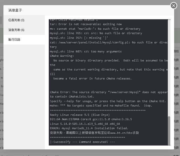

en....Where can I find the log file?

--2025-03-06 13:44:24-- https://dg2.bt.cn/src/mariadb-.tar.gz
Resolving dg2.bt.cn (dg2.bt.cn)... 36.133.1.8, 240e:97e:4000:33f:103:212:48:148
Connecting to dg2.bt.cn (dg2.bt.cn)|36.133.1.8|:443... connected.
Length: 0 [application/octet-stream]
Saving to: ‘/www/server/mysql/src.tar.gz’
0K 0.00 =0s
2025-03-06 13:44:24 (0.00 B/s) - ‘/www/server/mysql/src.tar.gz’ saved [0/0]
gzip: stdin: unexpected end of file
tar: Child returned status 1
tar: Error is not recoverable: exiting now
mv: cannot stat 'mariadb-': No such file or directory
mysql.sh: line 765: cd: src: No such file or directory
mysql.sh: line 767: [: missing `]'
cat: /www/server/panel/install/mysql/config.pl: No such file or directory
mysql.sh: line 807: cd: too many arguments
CMake Warning:
No source or binary directory provided. Both will be assumed to be the
same as the current working directory, but note that this warning will
become a fatal error in future CMake releases.
CMake Error: The source directory "/www/server/mysql" does not appear to contain CMakeLists.txt.
Specify --help for usage, or press the help button on the CMake GUI.
make: *** No targets specified and no makefile found. Stop.
Rocky Linux release 9.5 (Blue Onyx)
Bit:64 Mem:15704M Core:8 gcc:11.5.0 cmake:3.26.5
Linux 5.14.0-503.14.1.el9_5.x86_64 x86_64
ERROR: mysql mariadb_11.4 installation failed.
安装失败,请截图以上报错信息发帖至论坛www.bt.cn/bbs求助
I think it may be a problem here.
This file size is 0. I tried downloading it manually. Still 0.
0K 0.00 =0s
