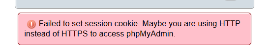

aaP_sepladmin ok thanks i used reverseproxy it worked by domain name but have error Failed to set session cookie. Maybe you are using HTTP instead of HTTPS to access phpMyAdmin.
aaPanel_Kern Hello, you can access the domain name by setting SSL and using the target address 127.0.0.1:887 port. 887 is the https port of phpmyadmin by default. Please modify it if it has been modified. aaP_sepladmin
