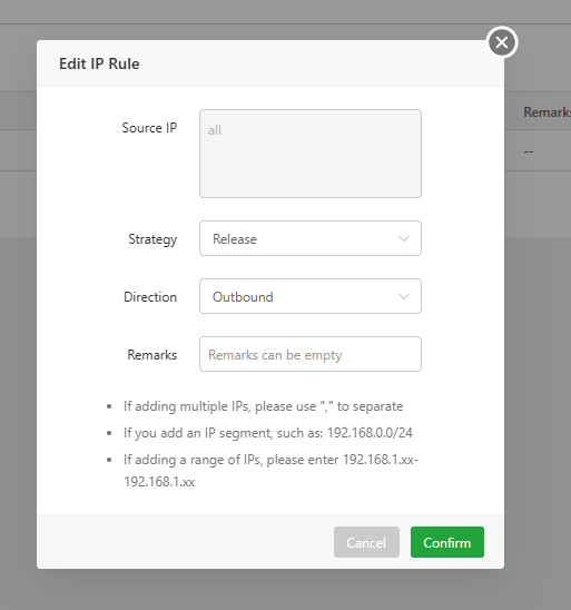

Hi all, I had a server crash eysterday. I ws able to restore it from backup files but I am having problems now. I don't even know where to begin and I'm reaching out to you all for help. Im not the best IT tech in fact i really don' tknow what im doing. here is my issue In aapanel all of my installs stopped working i can't update whneI do an install I get resolcing node.aapanel.com failes temporary failure in name resolution. Thats just one of problems the other is if I go to terminal in aapanel it says {'result': 'Connection failure: Authentication failed ,dhp@127.0.0.1:22'}. Ye I know the password is correct. In fact everyonce in awhile it works (Whats that about). I can ssh in from my pc thought using the same user and password. also I can't seem to access curl in my PHP scripts anymore. one more thing is if I try to ping anything external i can't, for example:
root@dhptraining:~/.config/code-server# ping -c 2 google.com
ping: google.com: Temporary failure in name resolution
this is really affecting my work flow and cuasing me issues. Please does aybody have any ideas I jumped in ubuntu because I was forced into this position and I just don't know enough
