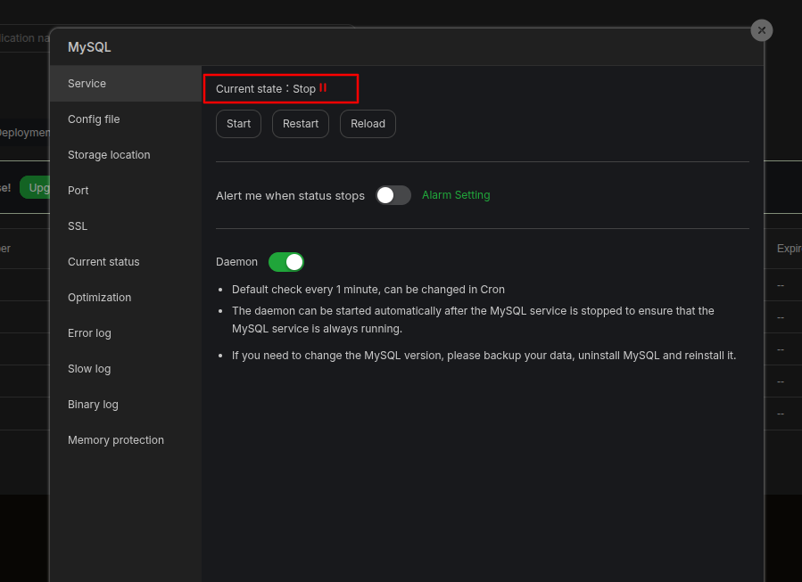

Now getting this issues MySQL 10.11.10-MariaDB service not starting
