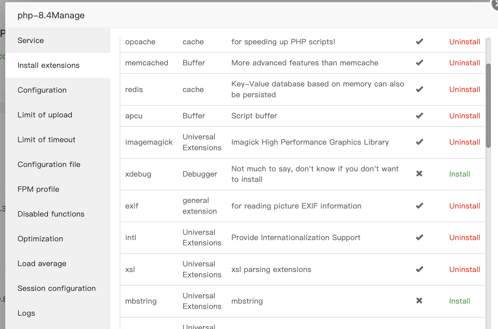

I installed the mbstring extension for PHP 8.4 on aaPanel and it is working correctly on the server. PHP scripts can use mbstring functions without any issue.
However, inside the PHP Manager (php-8.4 Manage -> Install extensions), aaPanel still shows mbstring as not installed and only displays the green “Install” button.
I already verified:
- php -m | grep mbstring returns mbstring
- phpinfo() shows mbstring enabled
- PHP-FPM restarted successfully
- Extension works normally in applications
So this seems to be only a UI/status detection problem inside aaPanel.
Has anyone experienced this before or knows how aaPanel checks installed extensions internally?
I attached a screenshot below.
