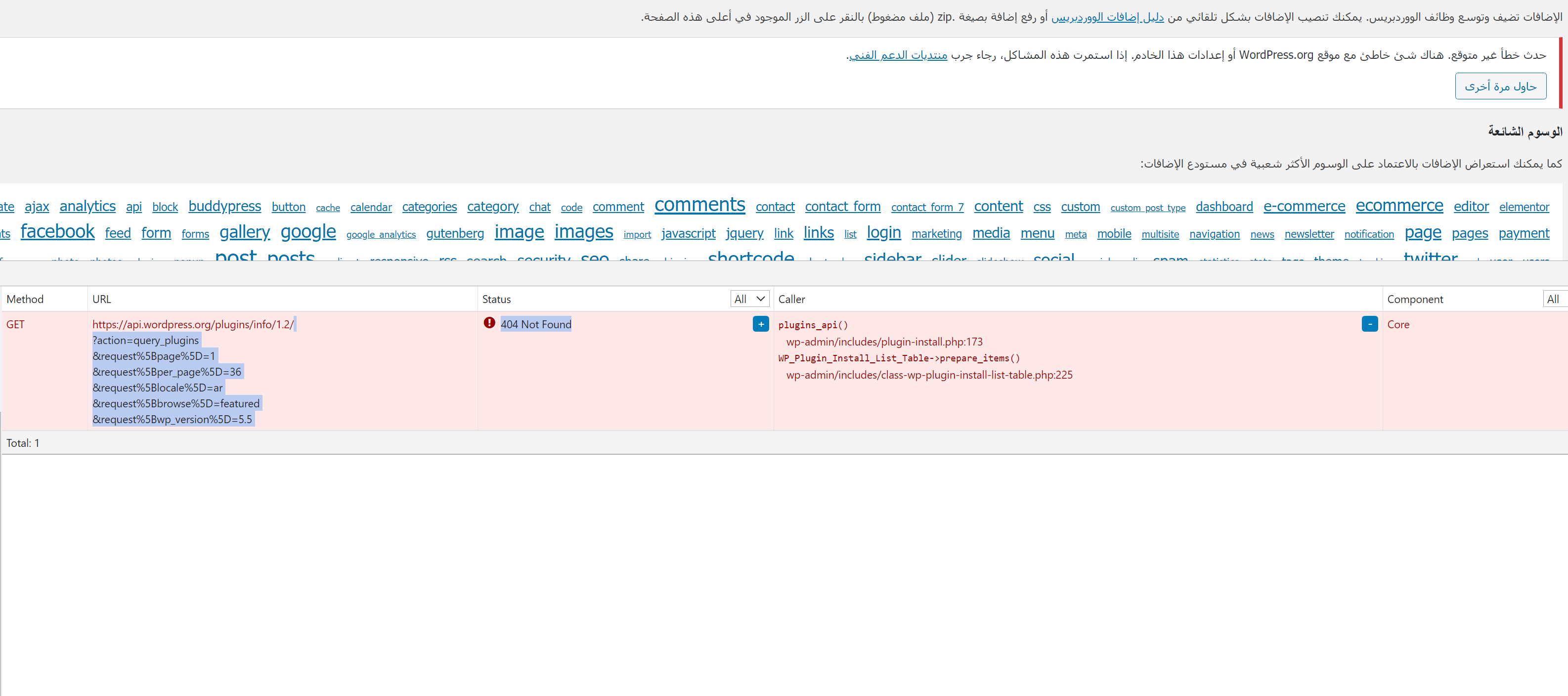

I've tried to add firewall IPs, URLs, rules but with no luck, WordPress can't access the WordPress outbound address,
also tried to add
define('WP_HTTP_BLOCK_EXTERNAL', false);
to the wp-config.php but without any luck

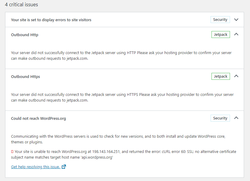

i keep getting messages like:
Warning: An unexpected error occurred. Something may be wrong with WordPress.org or this server’s configuration.
Communicating with the WordPress servers is used to check for new versions, and to both install and update WordPress core, themes or plugins.
Error Your site is unable to reach WordPress.org at 198.143.164.251, and returned the error: cURL error 60: SSL: no alternative certificate subject name matches target hostname 'api.wordpress.org'
