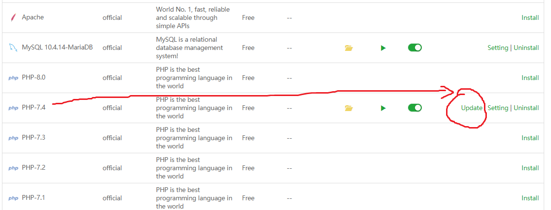

I have clicked on the update but the update still appears
why does "update" always appear in php?

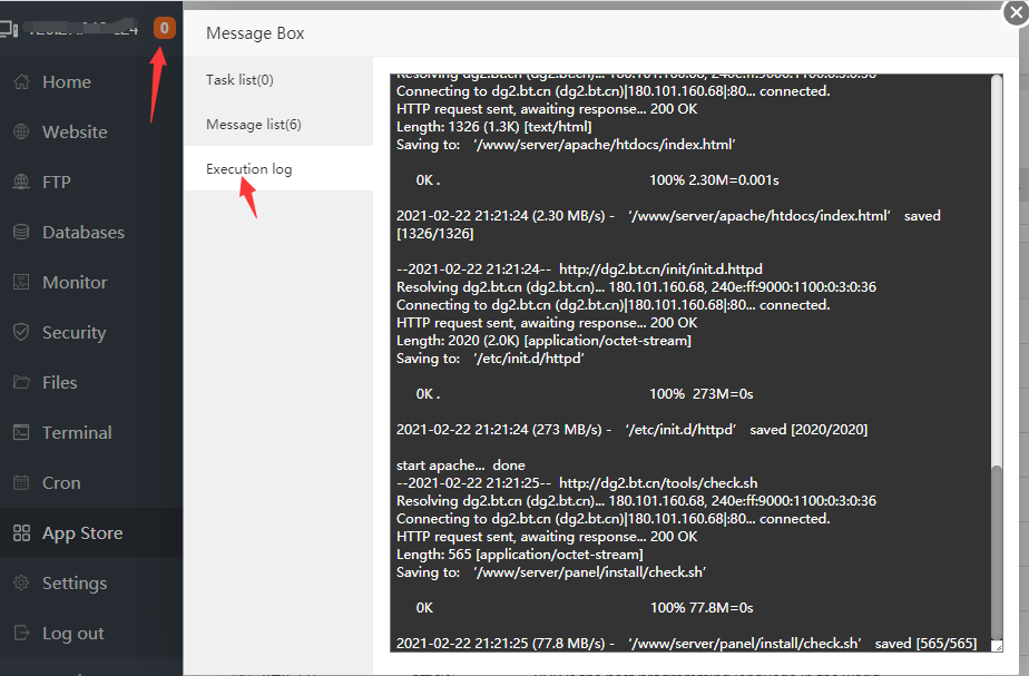

helloοΌlook at the execution log
aaPanel_Captain what I experience is ... if I click update, there is no response ...

I have clicked on the update, but there is no change ... I also deleted the PHP version but when it was installed, the update still appeared

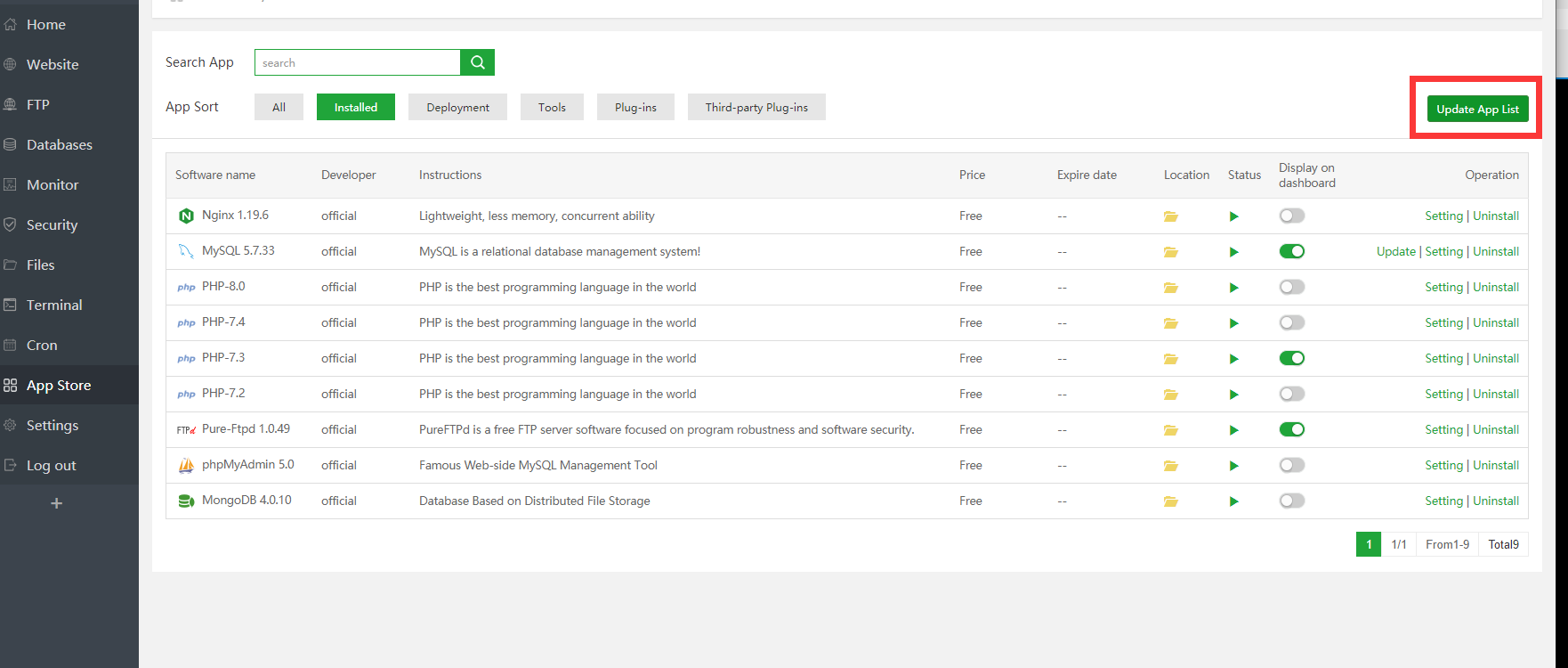

Hello, brother, this problem has been solved, you Update App List, it's fine
Hello, brother, thank you for your feedback and good luck
aapanel_power Update Apps List is working, thanks bro.
aapanel_power waahh..thanks brother
