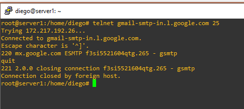

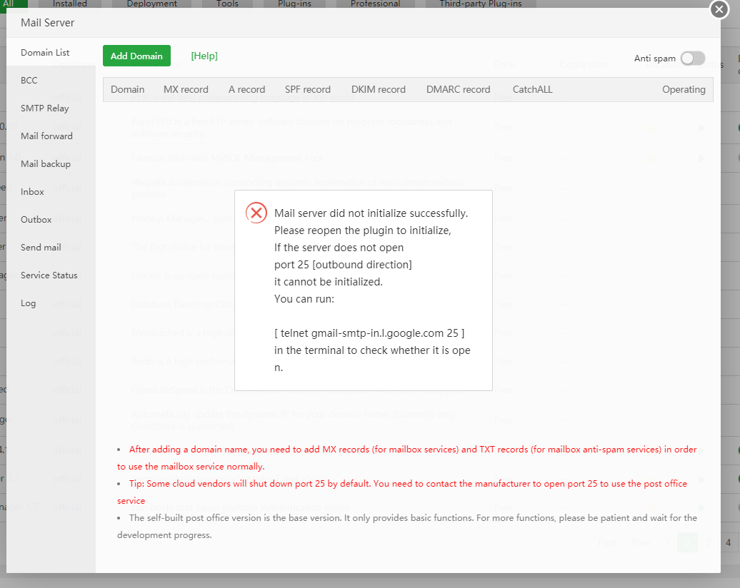

I think there are no problems with port 25 since it is not blocked, I did the telnet test to google and it works, even so, just in case I added it to ufw but there are no changes.
I think the problem, according to the mail log, is that the service does not start due to an error.

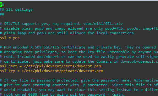

mar 21 19:10:28 server1 dovecot[28938]: doveconf: Fatal: Error in configuration file /etc/dovecot/conf.d/10-ssl.conf line 14: ssl_cert: Can't open file /etc/pki/dovecot/certs/dovecot.
mar 21 19:10:28 server1 systemd[1]: dovecot.service: Main process exited, code=exited, status=89/n/a
mar 21 19:10:28 server1 systemd[1]: dovecot.service: Failed with result 'exit-code'.
root@server1:/home/diego#
according to this, I see an ssl error, those certificates do not exist in the system.
