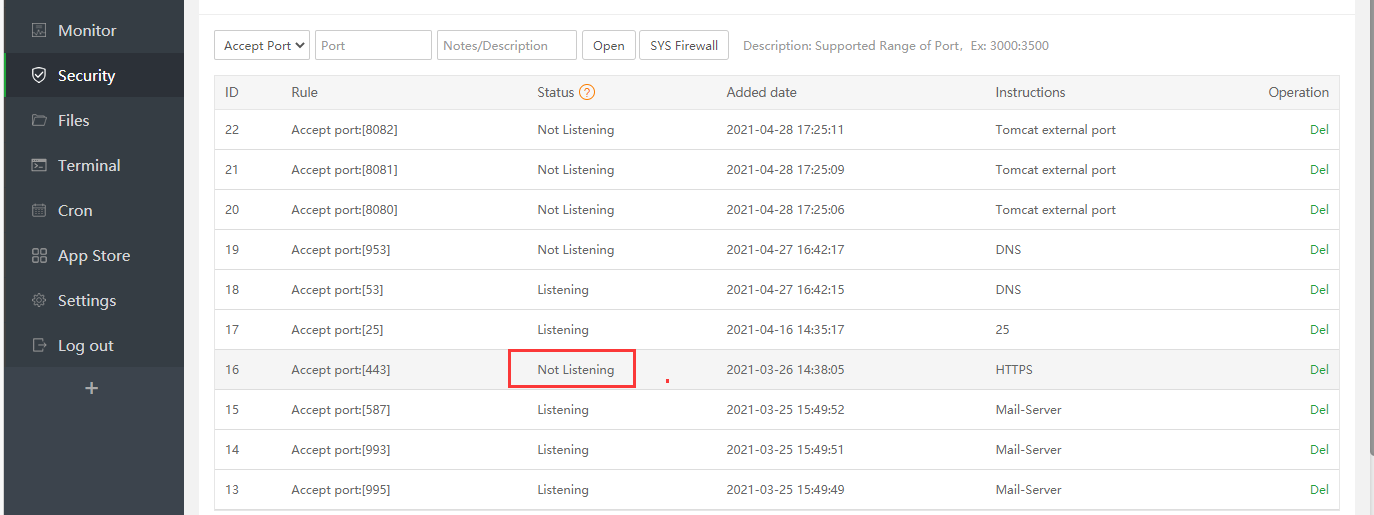

aapanel_sniper aaP_benfany_aditia Hello, you need to allow port 443 communication on the security page. If it is abnormal in the red box below, you need to redeploy SSL to activate it.
aaP_benfany_aditia aapanel_sniper hi thank you, i forgot to allow port 443 on my Mikrotik Router.. 😆 now it's working.. thank you for your help regards ben
