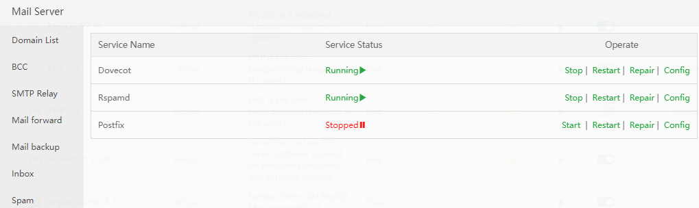

I tried uninstalling mail server and installing it back but still the same problem
here is the log
