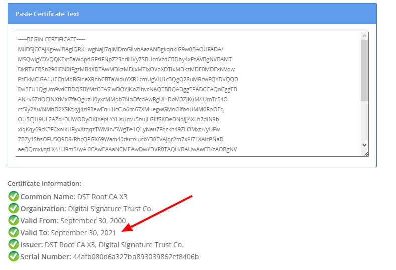

depth=3 O = Digital Signature Trust Co., CN = DST Root CA X3
verify error:num=10:certificate has expired
notAfter=Sep 30 14:01:15 2021 GMT

Navigate to /etc/pki/tls/certs and open / edit > ca-bundle.crt
Remove the following from the list :
# DST Root CA X3

Make sure you keep the same spacing between the certificates after deleting & Save the ca-bundle.crt file .
This file contains all the root / trust certificates of your server , and since LetsEncrypt main Root certificate has expired on September 30 2021 , postfix was giving certificate expired error while connecting through SMTP, even though my certificates were valid , this is caused because the certificates validation is done in chain.
