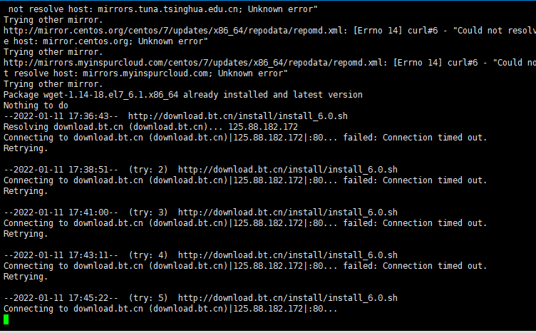

1, can not connect to our official installation node resulting in installation failure, as shown in the figure
From the figure can be analyzed, the above connection to Tsinghua source, centos official source and other third-party installation sources are prompted
Could not resolve host:mirros.tuna.tsinghua.edu.cn;Unknown error
It is likely that the DNS is not working, so you can set the DNS to a common one
echo 'nameserver 8.8.8.8' >>/etc/resolv.conf
echo 'nameserver 114.114.114.114' >>/etc/resolv.conf
If the generic DNS is still not working, you should consult the server operator to see if the DNS of the current network is malfunctioning

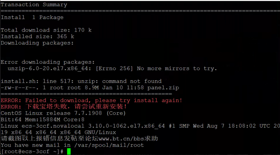

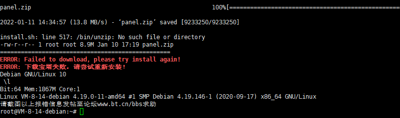

2, the lack of unzip caused by the unzip panel package can not be decompressed when the installation failed
This situation mostly occurs under Debian system, the lack of unzip, the solution
①、Debian|Ubuntu series
apt update -y
apt install unzip -y
If there is a prompt that unzip is Already installed or something like that, use the following command
apt reinstall unzip -y
②, Redhat|CentOS series: yum install unzip -y
yum reinstall unzip -y

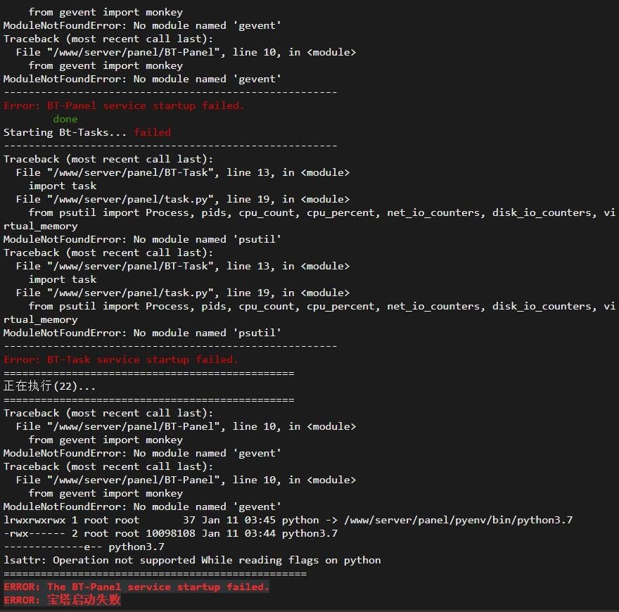

3、Lack of Python related dependencies
Common in Ubuntu aarch architecture series, gevent, psutil module is missing
Solution.
/www/server/panel/pyenv/bin/pip install gevent pustil
If prompted
/www/server/panel/pyenv/bin/pip No such file or directory
, please execute the following command to update the panel to the standalone python environment version.
curl https://node.aapanel.com/install/update_panel_en.sh|bash
