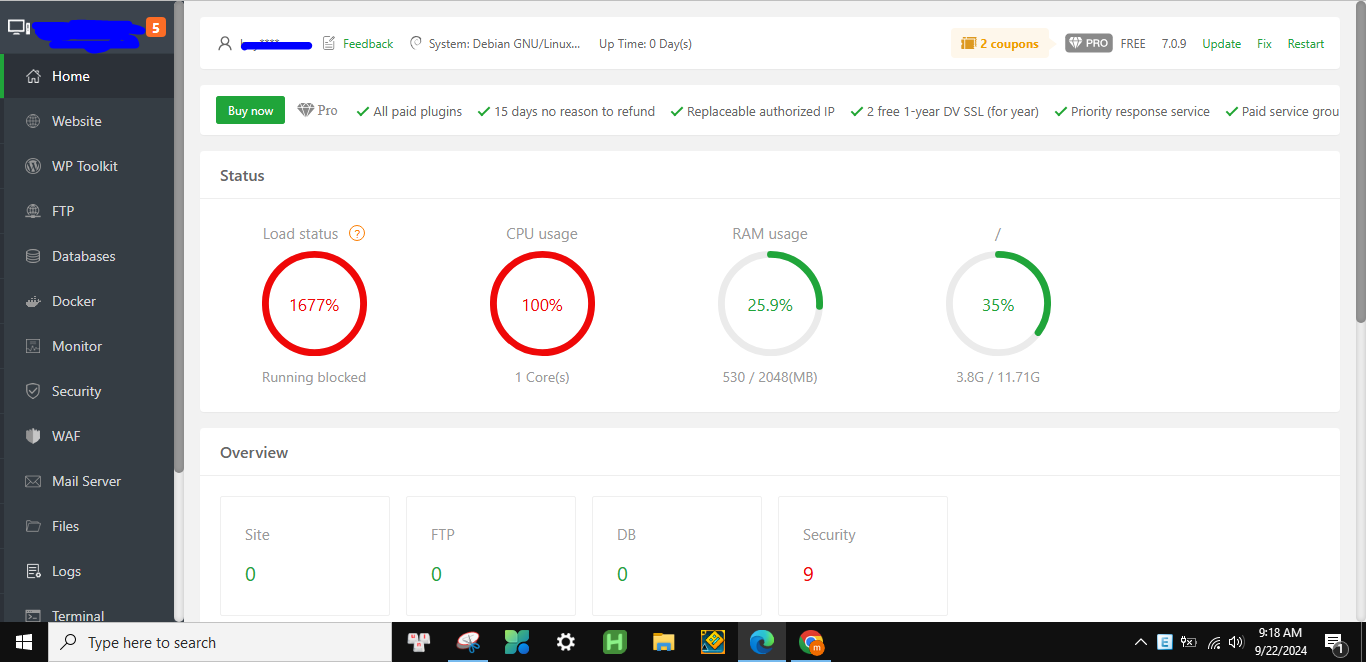

aaPanel_Kern Hello, it is recommended that you use VM instead of LXC container. LXC container has CPU identification problem. Brain
aaPanel_Kern Hello, this is a system or lxc container problem. It is recommended that you use VM. This is not aapanel's problem. You can use lscpu to check if the number of CPU cores you set is inconsistent. Brain

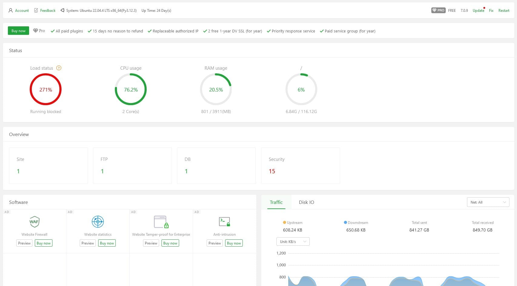

Tianheyu Is this normal?How it can over 100%? Checked it, All loads are below 100, the only possibility is that the physical machine load is too high. Can this conjecture be confirmedοΌ
aaPanel_Kern Hello, is this a server built using LXC? What version of operating system are you using? Tianheyu
Tianheyu aaPanel_Kern This is the VPS I purchased. I submitted a TICKET to the provider and it was resolved. Now it shows normal, so it should be their problem. System: CentOS 7.9.2009 x86_64 (Py3.12.3)

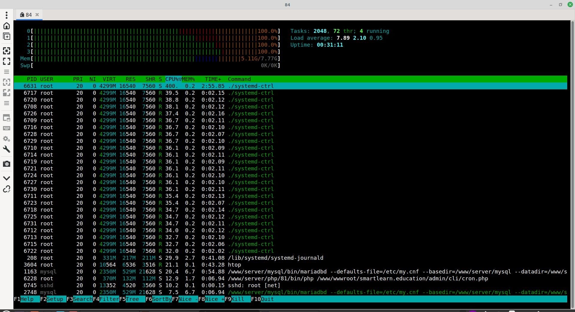

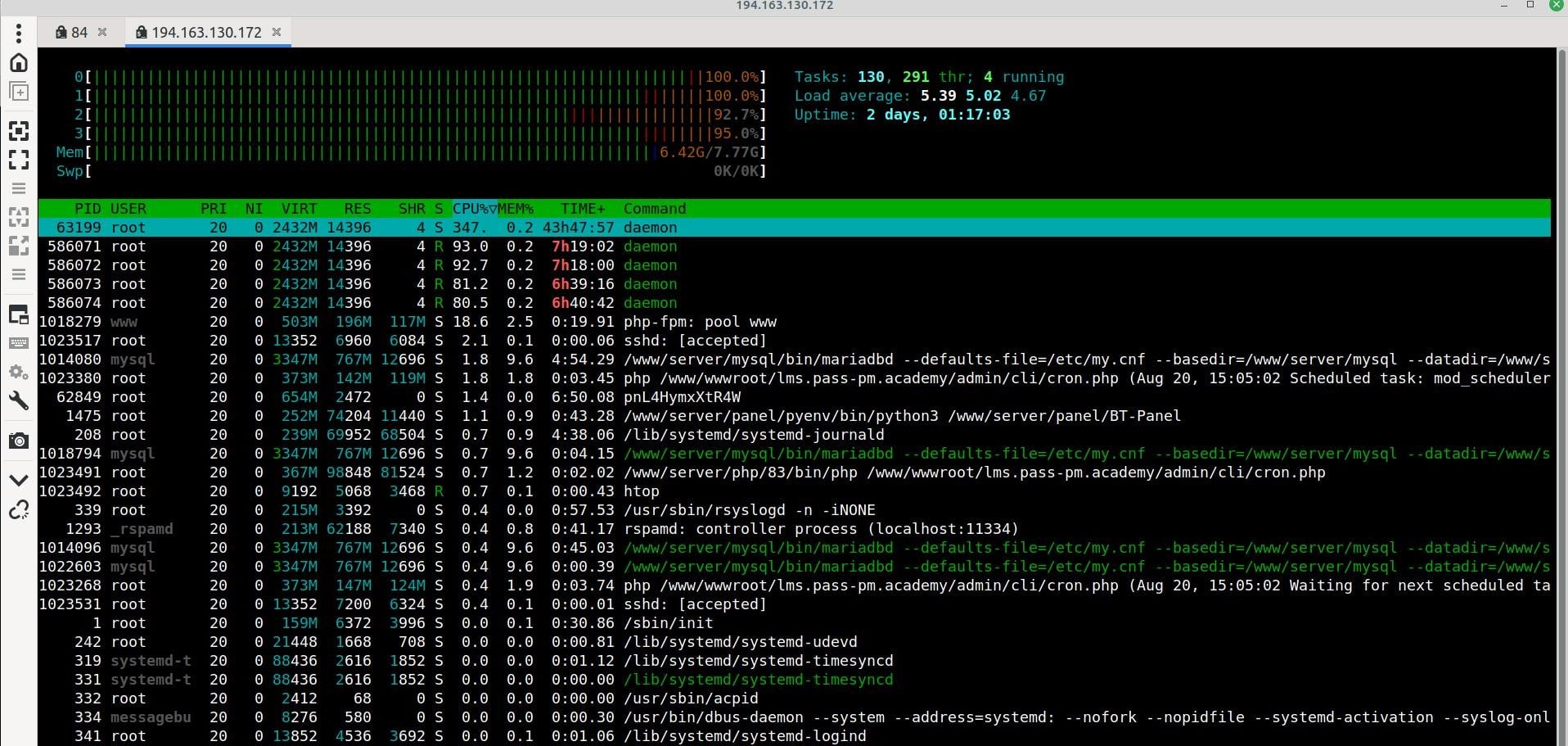

aaPanel_Kern Hello, please check the two programs daemon and systemd-ctrl. It seems that it is caused by a virus. Normally, these two programs do not exist. aaP_onlymade

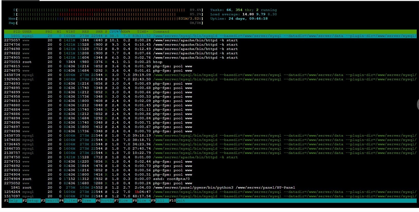

aaPanel_Kern Hello, it is recommended to use phpmyadmin to check which mysql processes are slow? Check if indexing is done? Also check whether the slow log of php is normal. belal
