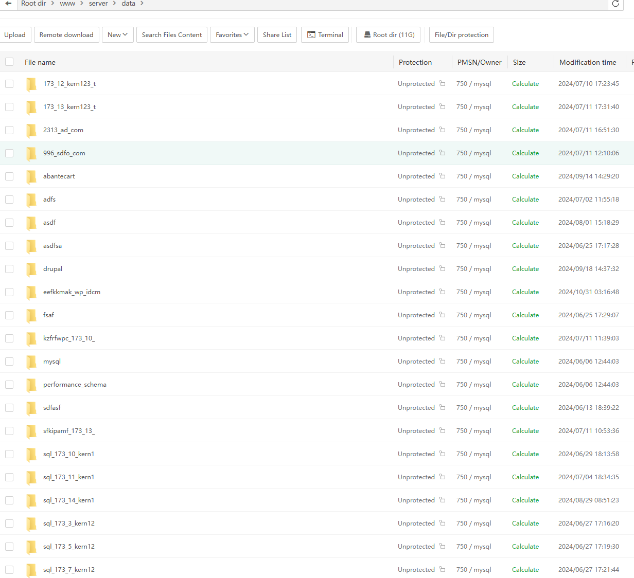

The default database storage path in the panel is:
/www/server/data
Backup directory command:
\cp -rp /www/server/data \www\backup\data_2022

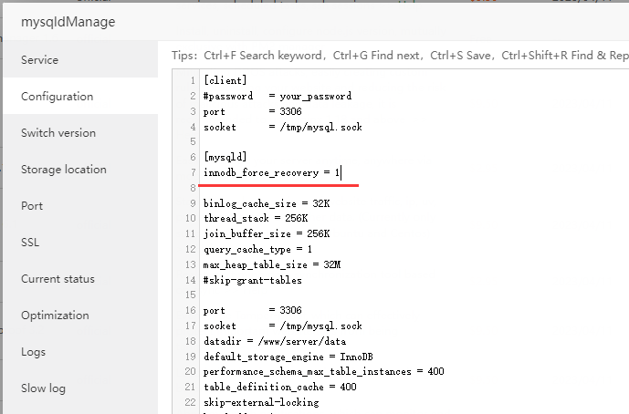

3, Add to the MySQL configuration file
The default MySQL configuration file for the panel is: /etc/my.cnf
innodb_force_recovery = 1
Restart the database after setting

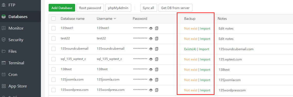

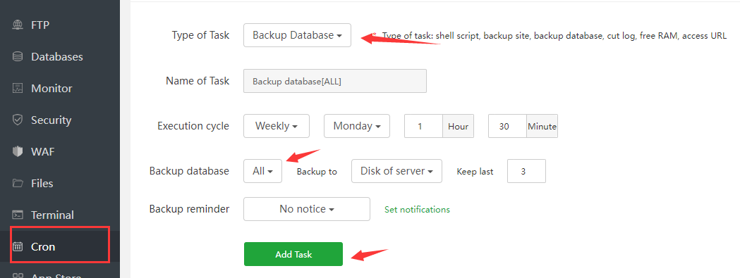

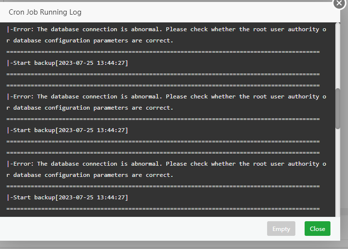

5, After restarting the database, back up the database as follows:
In the panel "Cron" set the backup database:
After setting, remember to click the "Execute" button, and pay attention to check whether the "Log" backup is successful. If the database is relatively large, the backup will take some time.
You can also back up by clicking the Backup button on the "databases" management interface.

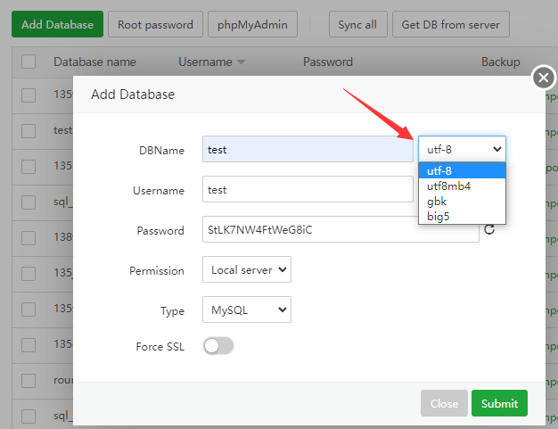

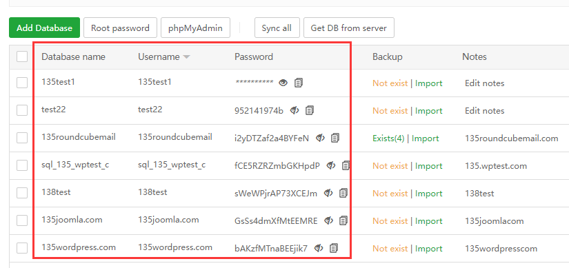

6, When the backup is completed and there is no error, stop the database service, back up the database name, user name and corresponding password to Notepad and save it, and then uninstall the current database
7, After reinstalling MySQL, create a new database, use the database name, user name and corresponding password saved to Notepad, and pay attention to the character set used by the database

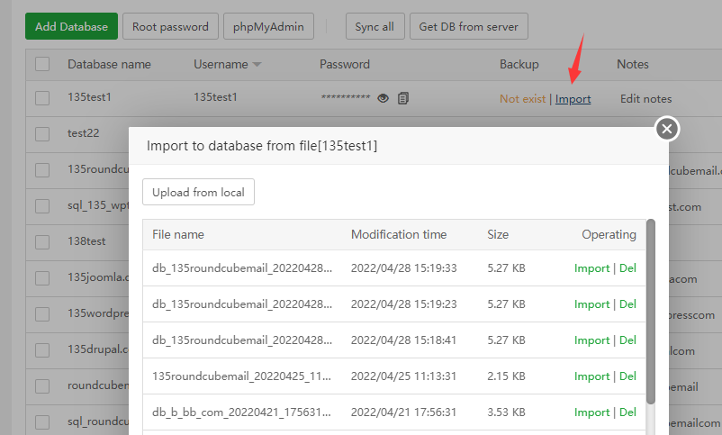

8, After restoring the latest backup database successfully, restart the web service and observe whether the website is normal.

Why copy the database name, user name and corresponding password?
A: To save time, creating a database on the panel will regenerate a random password. Currently, if the database information in your website is inconsistent with the information in the running database, you cannot connect. When creating a database, use the previous database name. , username and password to create a database, no need to modify the information in the website configuration file, so that it can be used directly after starting the web service
