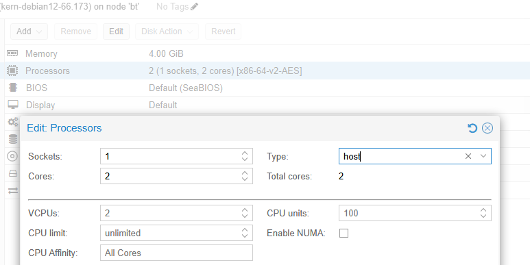

But I encountered another problem. that is, I cannot install mongoDB, either version 4.4, 6 / 7. I have tried to install all versions of mongoDB but the results are the same, the installation process runs normally with a successful status. but after that mongoDB is still not installed.
Here's a screenshot of the Execution Log
Please provide a solution for both the latest version of nginx and mongoDB installation. Thank you very much.
