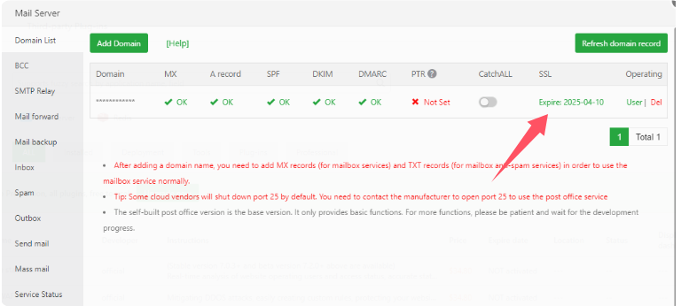

Mailserver 5.7 , OS Ubuntu 22.04.5 LTS
When signing the certificate / ssl from the mailserver interface it doesn't generate full chain pem file,missing letsencrypt cert on chain or smth ?, so my php script (laravel framework) fails to send because it cannot validate the ssl, i had to copy the pem and key of my website from the website section instead, so i can make it work, it needs to be fixed !!
This loggs in the mailserver when the php is triggering to send the e-mail.
