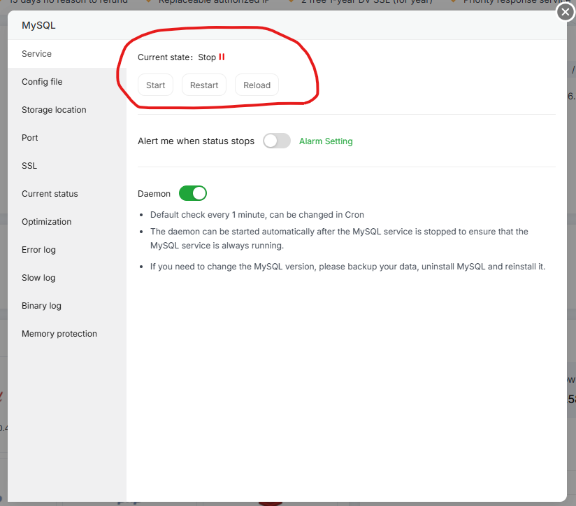

Hello,
I’m facing an issue with MySQL (MariaDB 11.4.4) on my VPS using aaPanel. The service shows as stopped in the panel, and when I try to start it, it doesn’t work properly.
Here are some details from the error log:
