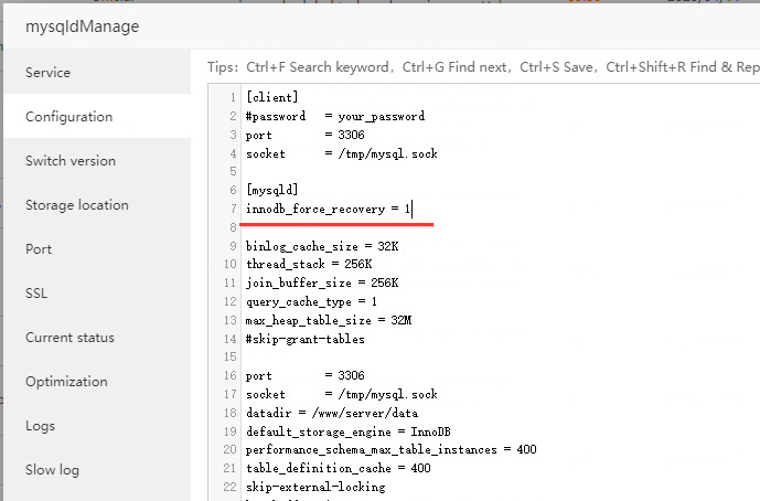

\cp -rp /www/server/data \www\backup\data_2022Add to the MySQL configuration file
The default MySQL configuration file for the panel is: /etc/my.cnf
innodb_force_recovery = 1

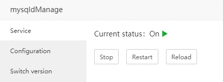

Restart the database after setting
innodb_force_recovery is a non-zero integer by default. There are a total of 6 parameter values 1--6. Refer to the official manual for parameter interpretation:

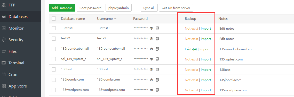

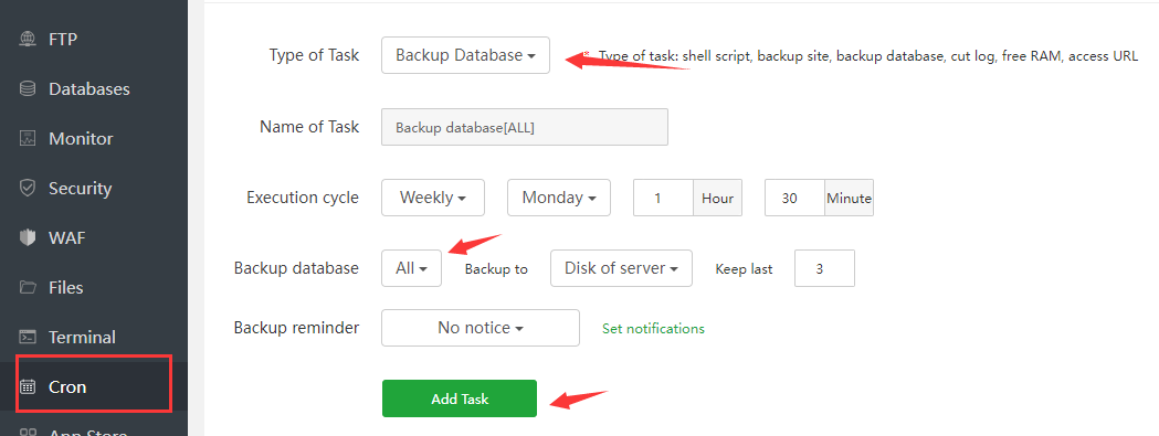

In the panel Cron set the backup databases:
After setting, remember to click the Execute button, and pay attention to check whether the Log backup is successful. If the database is relatively large, the backup will take some time.
You can also back up by clicking the Backup button on the Databases management interface.

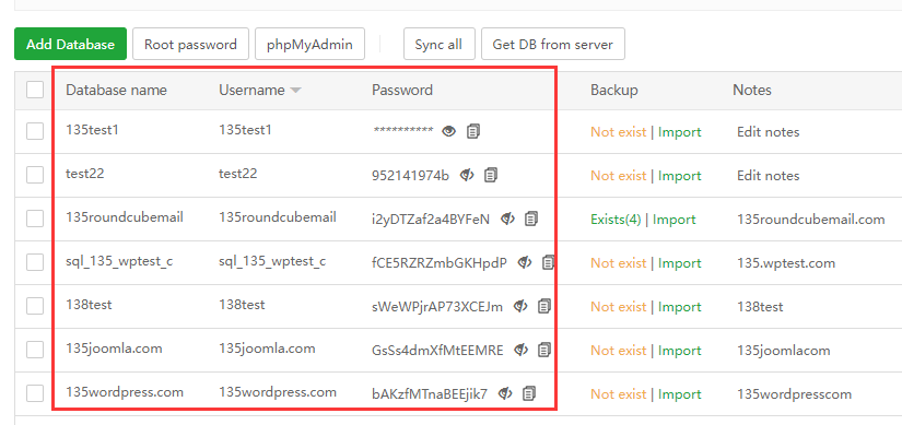

back up the Database name, username and corresponding passwordtoNotepad and save it, and then uninstall the current database
After

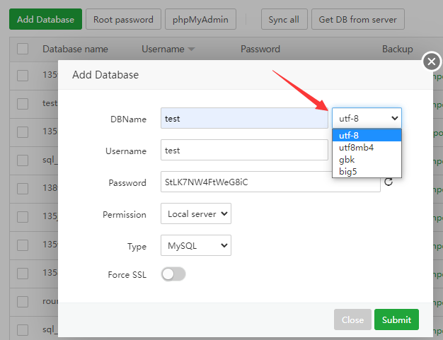

reinstalling MySQL, create a new database,use the database name, user name and corresponding passwordsaved to Notepad, and pay attention to the character set used by the database

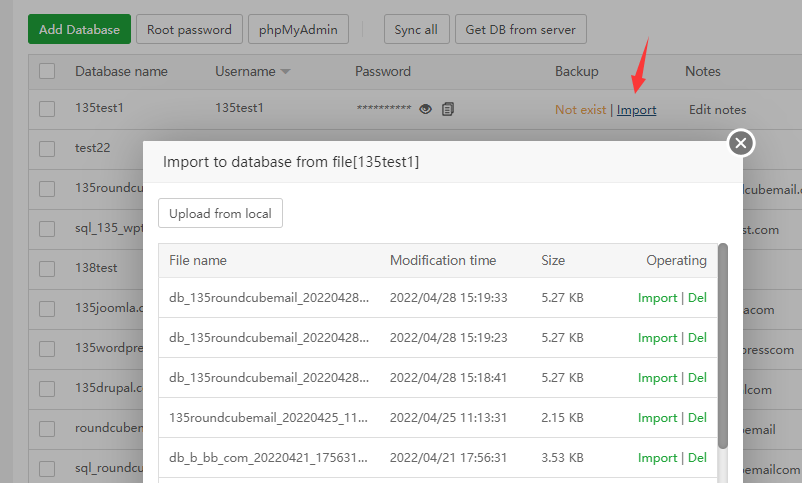

After restoring the latest backup database successfully, restart the web service and observe whether the website is normal.
