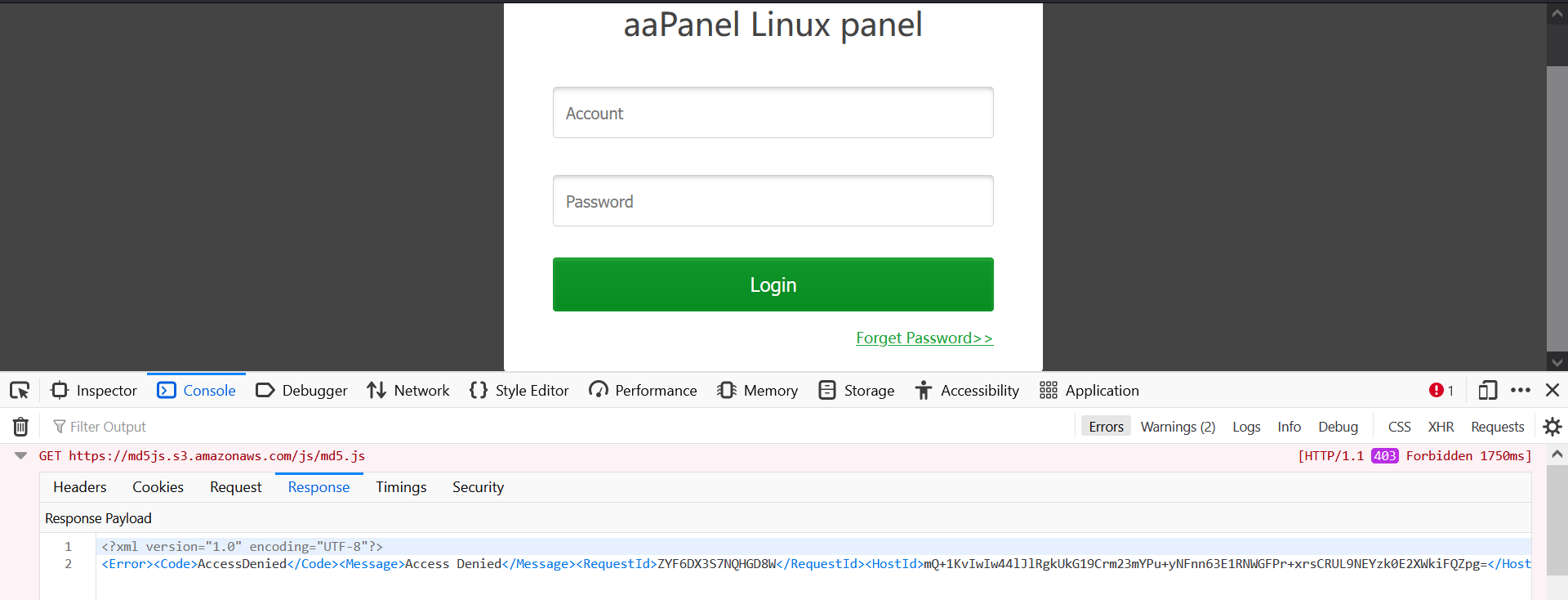

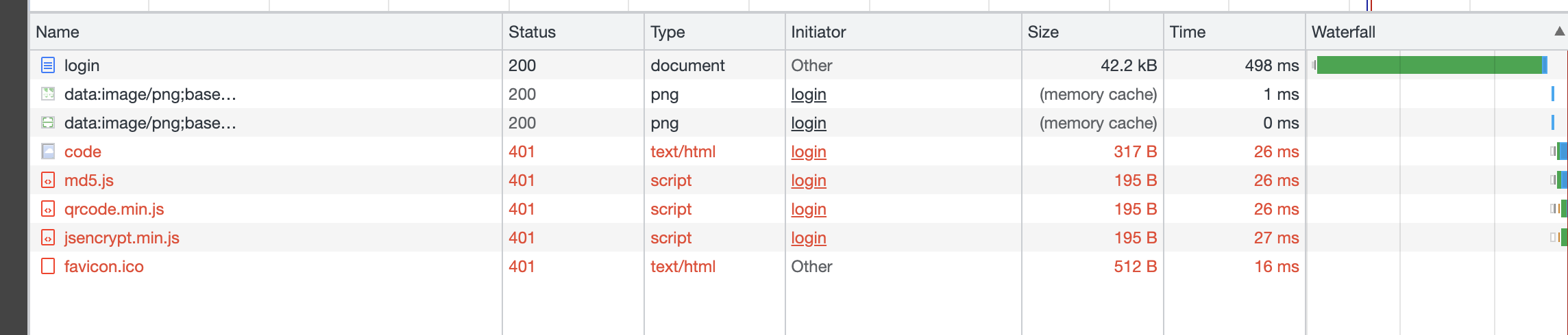

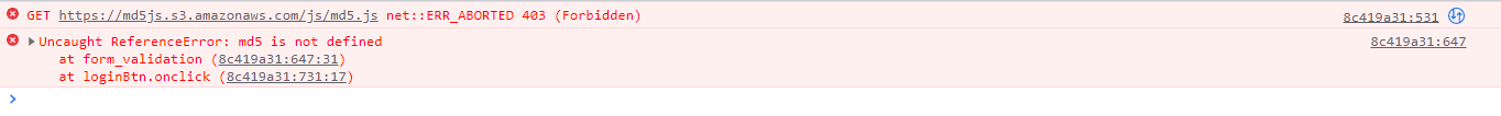

yt2mp3 aaPanel_Captain It works on VPN but not working on landline broadband or mobile networks. Why md5.js status code 307 Temporary Redirect ? What's issue can you please release fresh update with fixes.

yt2mp3 aaPanel_thisyear Issue fixed. Just runbt 16 ssh command to repair aapanel. Otherwise It will be just your browser cache issue.

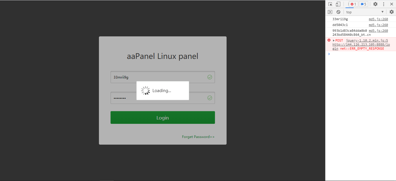

aaP_wixpadevs49 the problem again appeared i have already used bt 16 but it is not fixed when i login through proxy it goes to dashboard and redirects back to login page
aaPanel_Kern aaP_wixpadevs49 Hello,Try to use the incognito mode of the browser or change the browser access to solve the problem? If the problem cannot be solved, use the SSH tool to log in to the server and execute commands to view logs to check what the problem is. View log: bt 22
aaPanel_Kern aaP_rizwan_wixpa_com Hello,Try to use the incognito mode of the browser or change the browser access to solve the problem? If the problem cannot be solved, use the SSH tool to log in to the server and execute commands to view logs to check what the problem is. View log: bt 22
aaP_tiny13a hello. i have a problem. i don't login aapanel. i'm try use command 16 but it not recovery my problem. the console - 22 command log is empty i install aapanel with enable panel ssl. it's repair my problem. all ok. have a nice day
aaPanel_Kern aaP_usmanwixpa Hello, try to change the browser, is it normal to use the incognito mode of the browser to access? Also check if there is a file in the directory? ls -l /www/server/panel/ssl aaP_tiny13a
