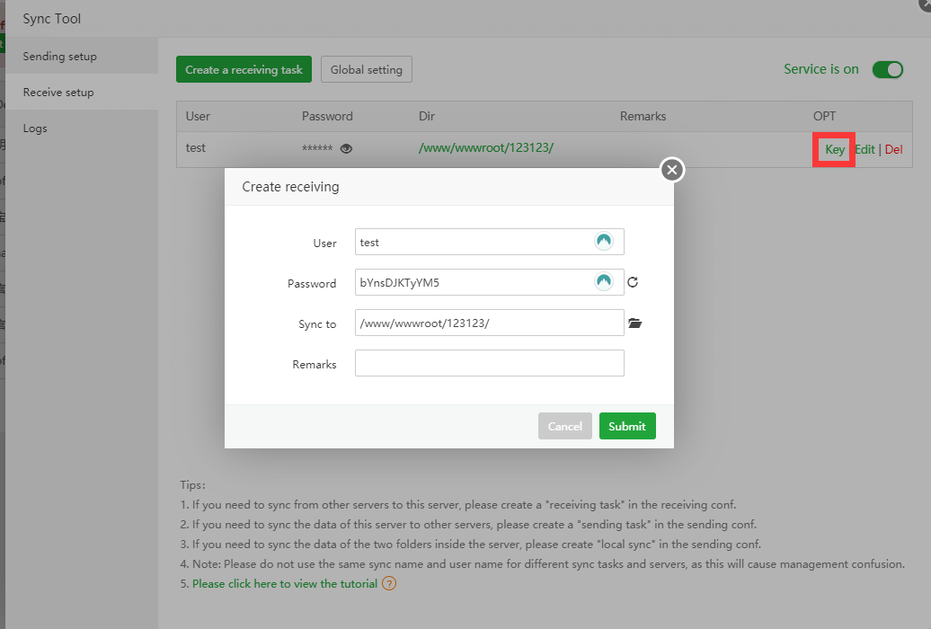

Add a receiving task
Add a receiving task on the server that receives the data and get the sync key
Note: please make sure the [Sync to] directory is empty, if there are files/dirs, please make a backup to prevent the data loss of the receiving server after selecting the mirror mode in the sending task

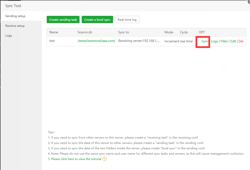

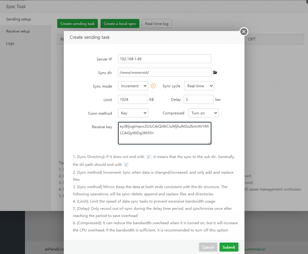

Add sending tasks
Add sending tasks to the data source server
After the setup is complete, check whether your two servers are configured correctly and then click the sync button to activate synchronization
