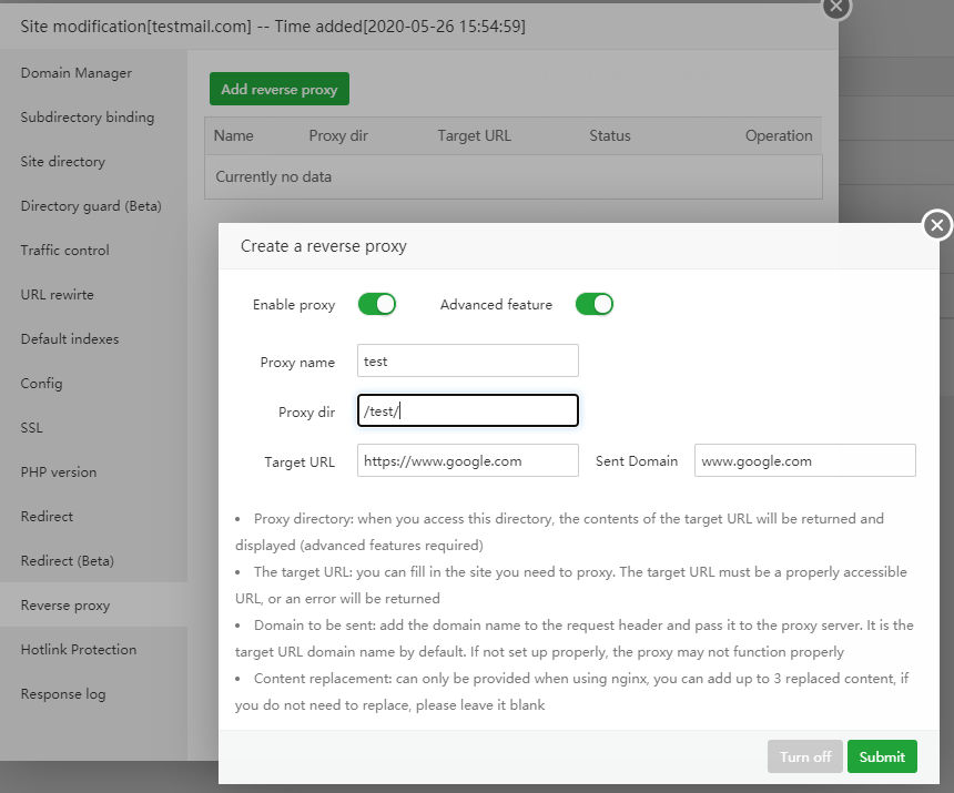

Domain https://shortsloader.com
--Proxy--
Target URL - https://ip-of-the-other-server
Example - https://192.168.25.42
Example 2 - https://64.192.127.22 if its a vps with a static public ip address.

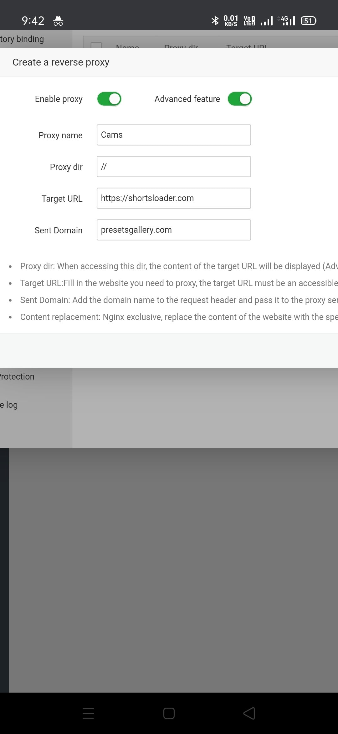

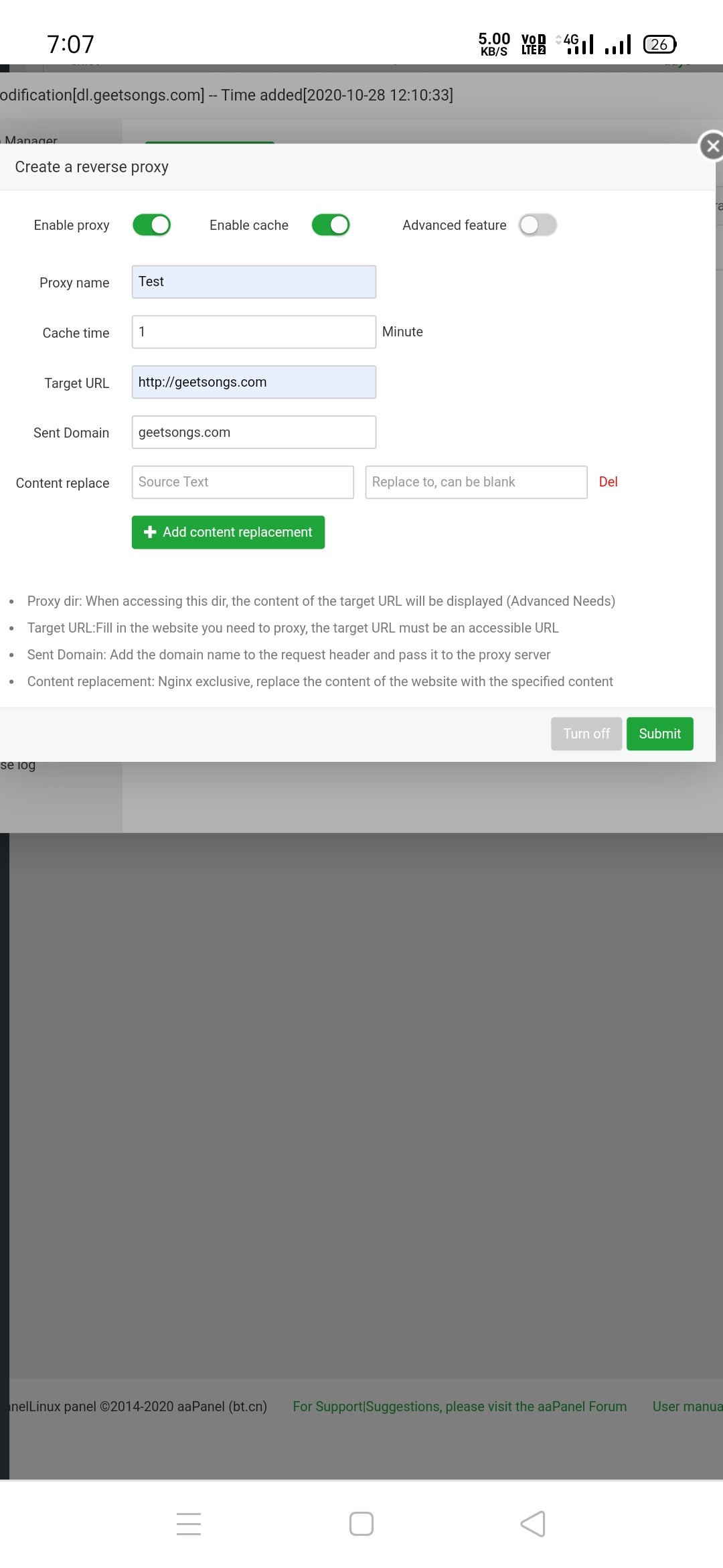

---Sent Domain---
shortsloader.com
The reason is because the reverse proxy needs to send the following headers to another webserver requesting that domain plus finishing the url path for other webpages for that domain.
If a user were to navigate to,
https://shortsloader.com/url/short/navigate.html
the reverse proxy will take that request, then pass through with shortsloader.com domain along with the url path including the requests for an ssl certificate.
(Example: https:192.168.25.42/url/short/navigate.html)
The responding webserver will then respond to reverse proxy and send back information such as.
All servers involved in the following chain are required to have the same ssl certificate otherwise the request will be dropped or browser may throw a warning message due to a missing or incorrect ssl certificate from one of the servers responsible for handling the requests of that domain.
