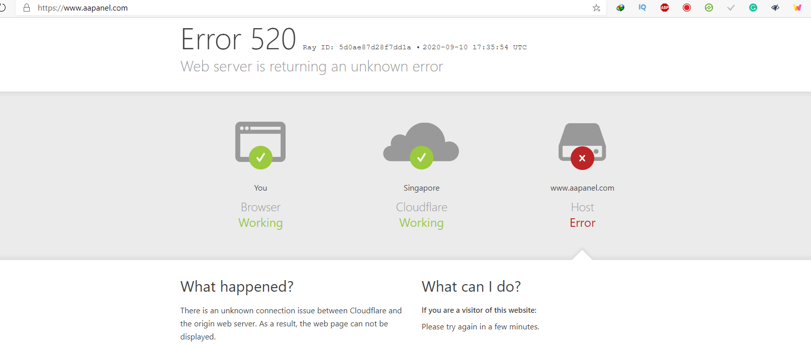

Off topic report:
Also, It seems like my IP address got blocked by aaPanel website lol too offensive firewall I guess.
Better check also the firewall as I am able to access aapanel forums from a tor browser but on my real ip it shows the server is down (most probably server side blocked or by cloudflare).
Just reporting this just in case the issue's can be replicated.
