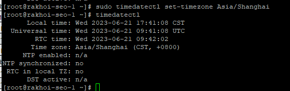

aaP_admin193 aaPanel_Kern this is what I did to change time zone. the local Time in command line and server time in setting are not exactly correct with my time on computer, the real time is over 17:42 at the time I checked time in command line and setting. they are a bit sooner.
