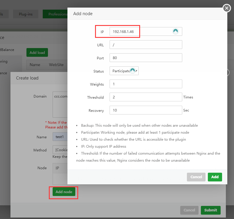

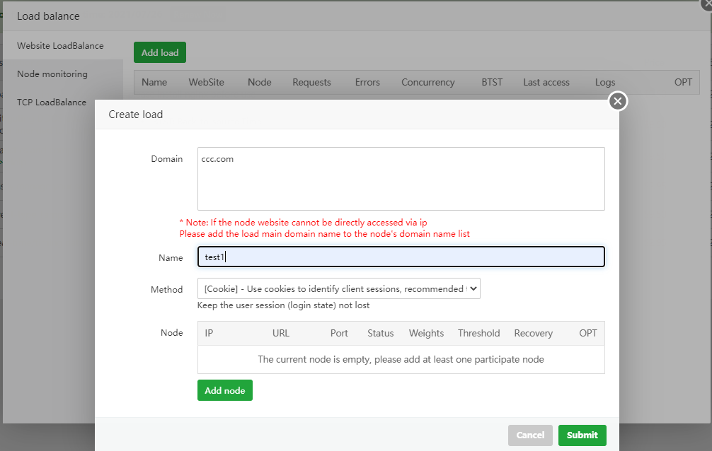

Add Load:
1. Click Add Load to fill in your website domain name (cannot exist in the website list)

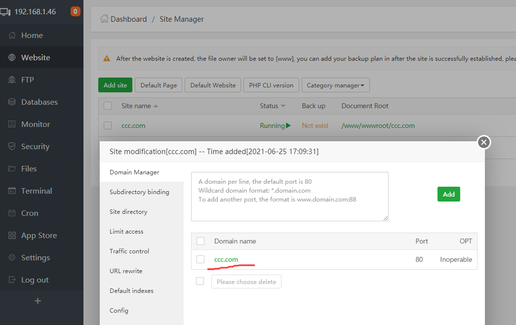

2. Add a website to your node server, the domain name of the website is the same as the main domain name
If your load node can use IP access, you don’t need to do this step
3. Go back to add a load balancing node in the plugin

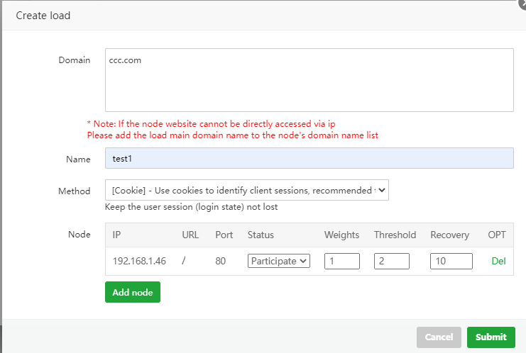

4. After the node is added, the interface is as follows

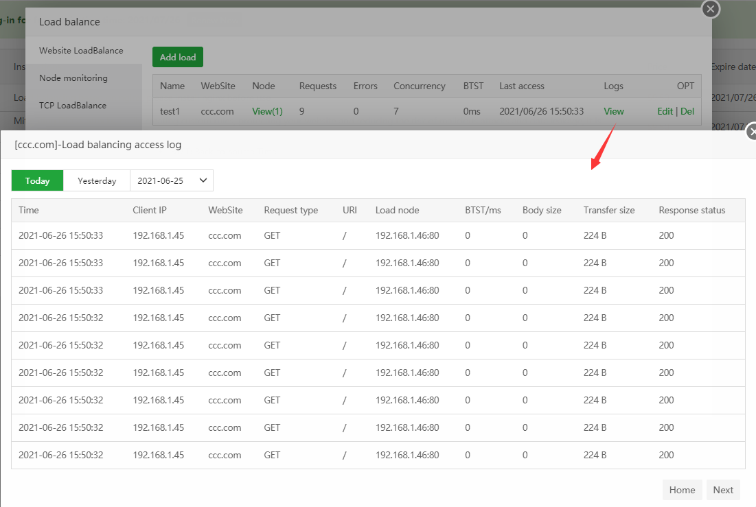

View Logs

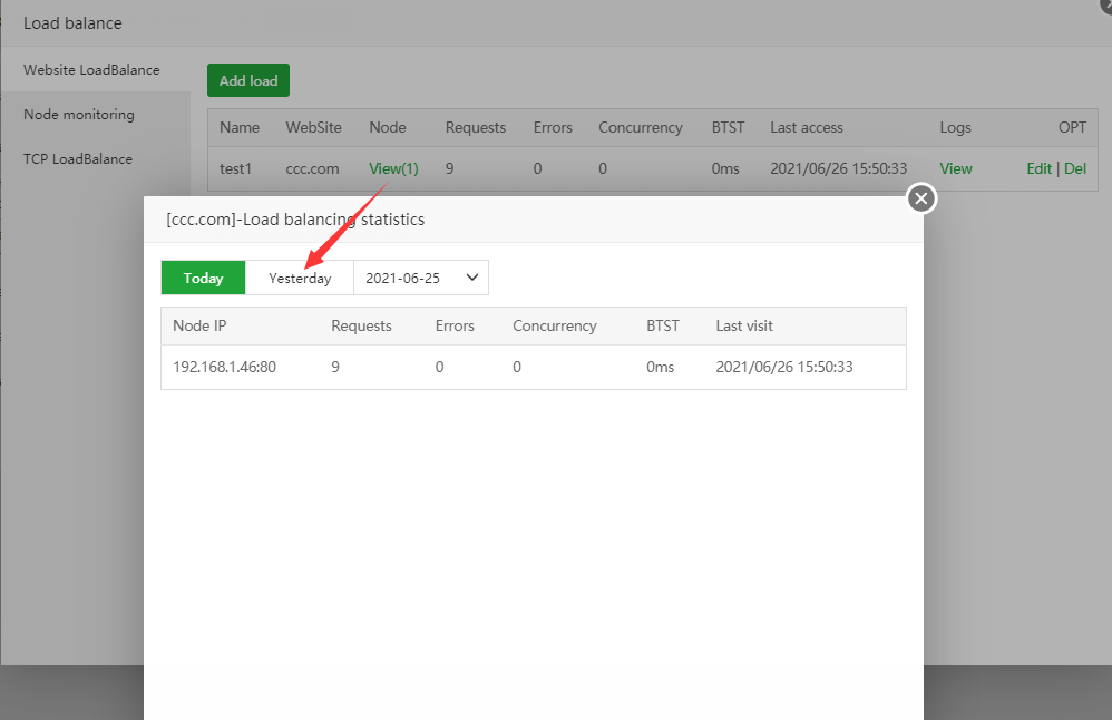

Node Status
